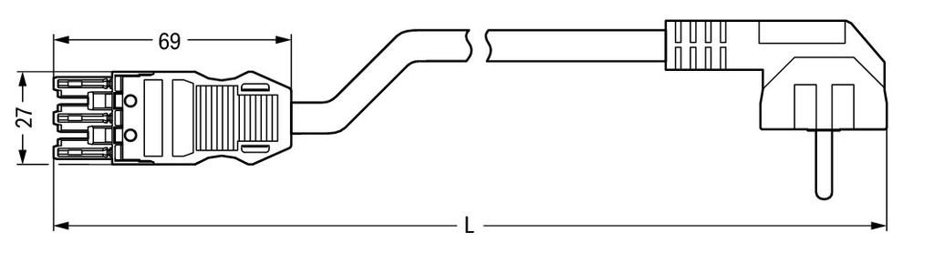

Соединительный кабель; Розетка - вилка углового исполнения стандарта CEE 7/4; 3-пол.; длиной 1 м; Кодирование А; с изоляцией из ПВХ
Maybo
771-9993/306-101
Wago
Wago 771-9993/306-102
CodingA
Цветwhite
Color of sheathed cablewhite
Connection typeSocket - SCHUKO plug, angled
Connector colorwhite
Contact materialCopper or copper alloy, surface-treated
Country of originDE
Cross section of single conductor1.5 mm²
Degree of protectionIP20
Durchmesser der Mantelleitung7.4 … 9.4 mm
Fire load3.652 MJ
Flammability class per UL94V0
GTIN4044918587983
Ground functionwith preceding GND contact
Insulating materialPolyamide 66 (PA 66)
Legend (ratings)(III / 3) ≙ Overvoltage category III / Pollution degree 3
Locking leverнет
Locking of plug-in connectionlocking lever
MarkingL ⏚ N
Mating force of a plug-in connectionapprox. 20 … 70 N (depending on pole number)
Mismating protectionYes
Number of Poles3
Pin spacing10 mm (0.394 inch)
Potential markingL ⏚ N
Printing color of mating faceblack
Printing color of sheathed cableblack
Printing color of strain reliefblack
Rated current16 A
Rated impulse voltage (III / 3)4 kV
Rated voltage (III / 3)250 В
Reaction to fire class per EN 50575Eca
Retention force of a plug-in connectionwhen locked: > 80N
Sheath materialPVC
Strain relief colorwhite
Surrounding air (operating) temperature-35 … 85 °C
Total length1 m
Total number of potentials3
Type of cableH05VV-F 3G1.5
Type of cable assemblyInterconnecting cable
Unmating force of a plug-in connectionwhen unlocked: approx. 20 … 70 N (depending on pole number)
