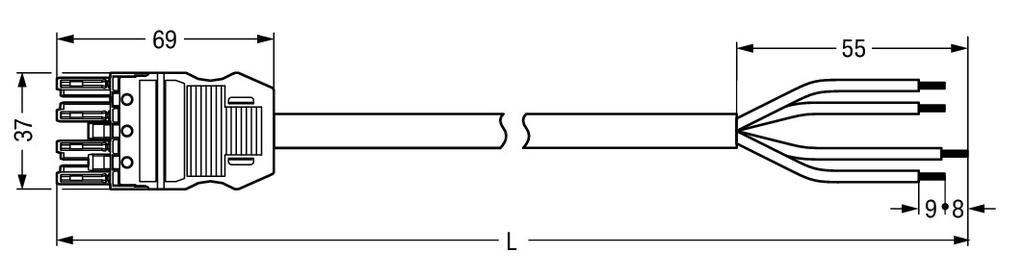

предв. собранный соединительный кабель; Eca; Розетка/открытая; 4-пол.; Код. A; H05Z1Z1-F 4G 1,5 мм²; 8 m
Maybo
771-9994/116-502
Wago
Wago 771-9994/116-802
CodingA
Цветwhite
Color of sheathed cablewhite
Conductor preparationtip-bonded
Connection typeSocket - free end
Connector colorwhite
Contact materialCopper or copper alloy, surface-treated
Country of originDE
Cross section of single conductor1.5 mm²
Degree of protectionIP20
Durchmesser der Mantelleitung8.4 … 10.5 mm
Fire load14.789 MJ
Flammability class per UL94V0
GTIN4045454526337
Ground functionwith preceding GND contact
Halogen-freeYes
Insulating materialPolyamide 66 (PA 66)
Legend (ratings)(III / 3) ≙ Overvoltage category III / Pollution degree 3
Locking leverнет
Locking of plug-in connectionlocking lever
MarkingN ⏚ 2|L 1|L'
Mating force of a plug-in connectionapprox. 20 … 70 N (depending on pole number)
Mismating protectionYes
Number of Poles4
Pin spacing10 mm (0.394 inch)
Potential markingN ⏚ 2/L 1/L'
Printing color of mating faceblack
Printing color of sheathed cableblack
Printing color of strain reliefblack
Rated current16 A
Rated impulse voltage (III / 3)6 kV
Rated voltage (III / 3)400 В
Reaction to fire class per EN 50575Eca
Retention force of a plug-in connectionwhen locked: > 80N
Strain relief colorwhite
Strip length55 мм
Surrounding air (operating) temperature-35 … 85 °C
Total length8 m
Total number of potentials4
Type of cableH05Z1Z1-F 4G1.5
Type of cable assemblyConnecting cable
Unmating force of a plug-in connectionwhen unlocked: approx. 20 … 70 N (depending on pole number)
