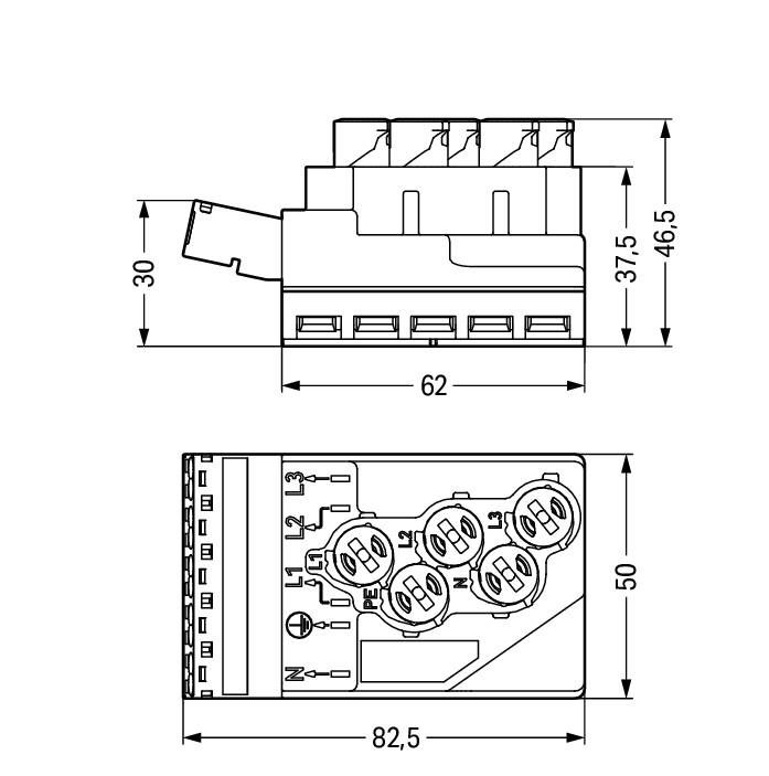

Модуль питания; с корпусом разгрузки натяжения; 5-пол.; Диаметр кабеля 9 - 13 мм; Кодирование P
Wago 772-267
Actuation typeOperating tool Push-in
Цветred
Connection technologyPush-in CAGE CLAMP®
Connection technology 2IDC connection
Contact materialCopper or copper alloy, surface-treated
Country of originDE
Degree of protectionIP20
Габариты: глубина82.5 mm / 3.248 inch
Fine-stranded conductor0.5 … 4 mm² / 20 … 12 AWG
Fine-stranded conductor with ferrule with plastic collar0.25 … 1.5 mm² / 20 … 16 AWG
Fine-stranded conductor with ferrule without plastic collar0.25 … 2.5 mm² / 20 … 14 AWG
Fine-stranded conductor with ferrule, push-in termination, from1.5 mm² / 16 AWG
Fire load2.221 MJ
Flammability class per UL94V0
GTIN4045454599515
Height46.5 mm / 1.831 inch
Insulating materialPolyamide 66 (PA 66)
Legend (ratings)(III / 3) ≙ Overvoltage category III / Pollution degree 3
MarkingN ⏚ L1 L2 L3
Mating force of a plug-in connectionapprox. 30–70N (depending on number of poles)
Mismating protectionYes
Nominal cross section4 mm²
Number of Poles5
Potential markingN ⏚ L1 L2 L3
Product Group20 (WINSTA)
Rated current25 A
Rated impulse voltage (III / 3)6 kV
Rated voltage (III / 3)400 В
Solid conductor0.5 … 4 mm² / 20 … 12 AWG
Solid conductor, push-in termination1.5 … 4 mm² / 16 … 12 AWG
Stranded conductor0.5 … 2.5 mm² / 20 … 14 AWG
Strip length9 mm / 0.35 Inch
Surrounding air (operating) temperature-35 … 85 °C
Total number of connection points10
Total number of potentials5
Unmating force of a plug-in connectionwhen unlocked: approx. 15–20N
Вес94.953 г
Ширина50 mm / 1.969 inch
