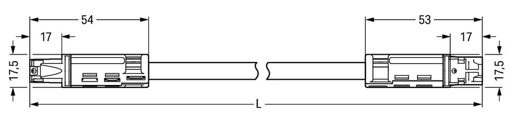

Datasheet Wago 774-9973/016-405 — Даташит
предв. собранный межблочный кабель; Eca; Розетка - штекер; 3-пол.; Код. S; 4m
774-9973/006-405 Wago | по запросу |
Coding | S |
Цвет | brown |
Connection type | Socket - Plug |
Connector color | brown |
Contact material | Copper or copper alloy, surface-treated |
Country of origin | DE |
Cross section of single conductor | 1.5 mm² |
Degree of protection | IP20 |
Durchmesser der Mantelleitung | 7.4 … 9.4 mm |
GTIN | 4055143522458 |
Halogen-free | Yes |
Legend (ratings) | (III / 3) ≙ Overvoltage category III / Pollution degree 3 |
Locking lever | да |
Locking of plug-in connection | locking lever |
Marking | 1 2 L |
Mating force of a plug-in connection | approx. 30 … 70 N (depending on pole number) |
Mismating protection | Yes |
Number of Poles | 3 |
Rated current | 16 A |
Rated impulse voltage (III / 3) | 4 kV |
Rated voltage (III / 3) | 250 В |
Reaction to fire class per EN 50575 | Eca |
Retention force of a plug-in connection | when locked: > 80N |
Strain relief color | black |
Surrounding air (operating) temperature | -35 … 85 °C |
Total length | 4 m |
Total number of potentials | 3 |
Type of cable | H05Z1Z1-F 3x1.5 |
Type of cable assembly | Interconnecting cable |
Unmating force of a plug-in connection | when unlocked: approx. 30 … 70 N (depending on pole number) |
Вес | 434.604 г |
