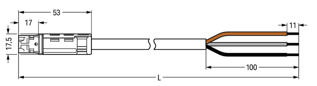

предв. собранный соединительный кабель; Eca; Штекер/открытый; 3-пол.; Код. S; 6 м
| 774-9973/006-405 Wago | по запросу | ||
| Coding | S |
| Цвет | brown |
| Conductor preparation | tip-bonded |
| Connection type | Plug - free end |
| Connector color | brown |
| Contact material | Copper or copper alloy, surface-treated |
| Country of origin | DE |
| Cross section of single conductor | 1.5 mm² |
| Degree of protection | IP20 |
| Durchmesser der Mantelleitung | 7.4 … 9.4 mm |
| Flammability class per UL94 | V0 |
| GTIN | 4055143522687 |
| Halogen-free | Yes |
| Insulating material | Polyamide 66 (PA 66) |
| Legend (ratings) | (III / 3) ≙ Overvoltage category III / Pollution degree 3 |
| Locking of plug-in connection | locking lever |
| Marking | 1 2 L |
| Mating force of a plug-in connection | approx. 30 … 70 N (depending on pole number) |
| Mismating protection | Yes |
| Number of Poles | 3 |
| Rated current | 16 A |
| Rated impulse voltage (III / 3) | 4 kV |
| Rated voltage (III / 3) | 250 В |
| Reaction to fire class per EN 50575 | Eca |
| Retention force of a plug-in connection | when locked: > 80N |
| Strain relief color | black |
| Strip length | 100 мм |
| Surrounding air (operating) temperature | -35 … 85 °C |
| Total length | 6 m |
| Total number of potentials | 3 |
| Type of cable | H05Z1Z1-F 3x1.5 |
| Type of cable assembly | Connecting cable |
| Unmating force of a plug-in connection | when unlocked: approx. 30 … 70 N (depending on pole number) |
| Вес | 642.823 г |
