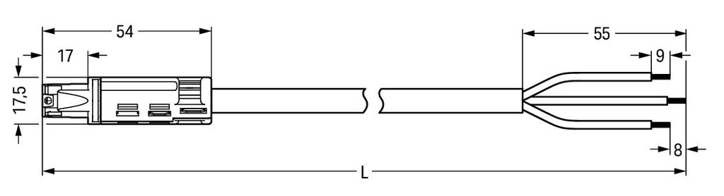

Datasheet Wago 774-9993/116-102 — Даташит
предв. собранный соединительный кабель; Eca; Розетка/открытая; 3-пол.; Код. A; H05Z1Z1-F 3G 1,5 мм²; 1 м
| 774-9993/116-201 Wago | по запросу | ||
| Цвет | white |
| Conductor preparation | tip-bonded |
| Connection type | Socket - free end |
| Connector color | white |
| Contact material | Copper or copper alloy, surface-treated |
| Country of origin | DE |
| Cross section of single conductor | 1.5 mm² |
| Degree of protection | IP20 |
| Durchmesser der Mantelleitung | 7.4 … 9.4 mm |
| Fire load | 1.702 MJ |
| Flammability class per UL94 | V0 |
| GTIN | 4045454323035 |
| Ground function | with preceding GND contact |
| Halogen-free | Yes |
| Insulating material | Polyamide 66 (PA 66) |
| Legend (ratings) | (III / 3) ≙ Overvoltage category III / Pollution degree 3 |
| Locking lever | да |
| Locking of plug-in connection | locking lever |
| Marking | L ⏚ N |
| Mating force of a plug-in connection | approx. 30 … 70 N (depending on pole number) |
| Mismating protection | Yes |
| Number of Poles | 3 |
| Rated current | 16 A |
| Rated impulse voltage (III / 3) | 4 kV |
| Rated voltage (III / 3) | 250 В |
| Reaction to fire class per EN 50575 | Eca |
| Retention force of a plug-in connection | when locked: > 80N |
| Strain relief color | white |
| Strip length | 55 мм |
| Surrounding air (operating) temperature | -35 … 85 °C |
| Total length | 1 m |
| Total number of potentials | 3 |
| Type of cable | H05Z1Z1-F 3G1.5 |
| Type of cable assembly | Connecting cable |
| Unmating force of a plug-in connection | when unlocked: approx. 30 … 70 N (depending on pole number) |
| Вес | 100.847 г |
