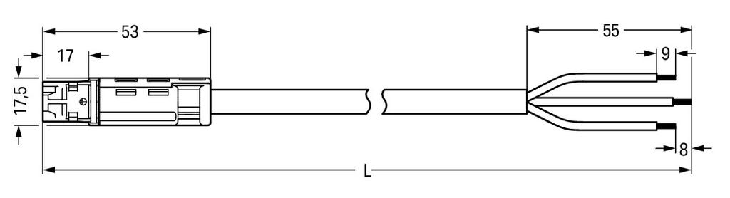

предв. собранный соединительный кабель; Eca; Штекер/открытый; 3-пол.; Код. A; H05VV-F 3G 2,5 мм²; 7 m
774-9993/007-501 Wago | по запросу |
Цвет | black |
Conductor preparation | tip-bonded |
Connection type | Plug - free end |
Connector color | black |
Contact material | Copper or copper alloy, surface-treated |
Country of origin | DE |
Cross section of single conductor | 2.5 mm² |
Degree of protection | IP20 |
Durchmesser der Mantelleitung | 9.2 … 11.4 mm |
Fire load | 18.682 MJ |
GTIN | 4045454324537 |
Ground function | with preceding GND contact |
Legend (ratings) | (III / 3) ≙ Overvoltage category III / Pollution degree 3 |
Locking of plug-in connection | locking lever |
Marking | L ⏚ N |
Mating force of a plug-in connection | approx. 30 … 70 N (depending on pole number) |
Mismating protection | Yes |
Number of Poles | 3 |
Rated current | 20 A |
Rated impulse voltage (III / 3) | 4 kV |
Rated voltage (III / 3) | 250 В |
Reaction to fire class per EN 50575 | Eca |
Retention force of a plug-in connection | when locked: > 80N |
Sheath material | PVC |
Strain relief color | black |
Strip length | 55 мм |
Surrounding air (operating) temperature | -35 … 85 °C |
Total length | 7 m |
Total number of potentials | 3 |
Type of cable | H05VV-F 3G2.5 |
Type of cable assembly | Connecting cable |
Unmating force of a plug-in connection | when unlocked: approx. 30 … 70 N (depending on pole number) |
