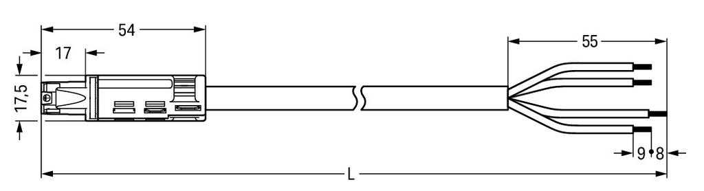

Datasheet Wago 774-9994/106-101 — Даташит
предв. собранный соединительный кабель; Eca; Розетка/открытая; 4-пол.; Код. A; H05VV-F 4G 1,5 мм²; 1 м
| 774-9994/106-201 Wago | по запросу | ||
| Coding | A |
| Цвет | black |
| Conductor preparation | tip-bonded |
| Connection type | Socket - free end |
| Connector color | black |
| Contact material | Copper or copper alloy, surface-treated |
| Country of origin | DE |
| Cross section of single conductor | 1.5 mm² |
| Degree of protection | IP20 |
| Durchmesser der Mantelleitung | 8.4 … 10.5 mm |
| Fire load | 2.269 MJ |
| Flammability class per UL94 | V0 |
| GTIN | 4045454345792 |
| Insulating material | Polyamide 66 (PA 66) |
| Legend (ratings) | (III / 3) ≙ Overvoltage category III / Pollution degree 3 |
| Locking lever | да |
| Locking of plug-in connection | locking lever |
| Marking | N ⏚ 2 1 |
| Mating force of a plug-in connection | approx. 30 … 70 N (depending on pole number) |
| Mismating protection | Yes |
| Number of Poles | 4 |
| Rated current | 16 A |
| Rated impulse voltage (III / 3) | 4 kV |
| Rated voltage (III / 3) | 250 В |
| Reaction to fire class per EN 50575 | Eca |
| Retention force of a plug-in connection | when locked: > 80N |
| Sheath material | PVC |
| Strain relief color | black |
| Strip length | 55 мм |
| Surrounding air (operating) temperature | -35 … 85 °C |
| Total length | 1 m |
| Total number of potentials | 4 |
| Type of cable | H05VV-F 4G1.5 |
| Type of cable assembly | Connecting cable |
| Unmating force of a plug-in connection | when unlocked: approx. 30 … 70 N (depending on pole number) |
| Вес | 135.128 г |
