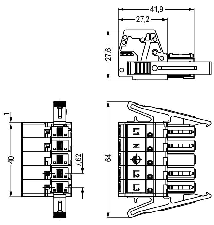

Wago 831-3105/1019-050
Actuation typeOperating tool Push-in
Clamping spring materialChrome nickel spring steel (CrNi)
CodingA
Цветwhite
Connectable sheathed cable diameter13 … 18 mm
Connection technologyPush-in CAGE CLAMP®
Connector connection typefor conductors
Contact materialCopper or copper alloy, surface-treated
Contact type (pluggable connector)Female connector/socket
Country of originDE
Degree of protectionIP20
Габариты: глубина41.9 mm / 1.65 inch
Fine-stranded conductor0.5 … 6 mm² / 20 … 8 AWG
Flammability class per UL94V0
GTIN4055143500753
Height27.55 mm / 1.085 inch
Insulating materialPolyamide 66 (PA 66)
Legend (ratings)(III / 3) ≙ Overvoltage category III / Pollution degree 3
Locking leverнет
Locking of plug-in connectionlocking lever
MarkingL1 N ⏚ L2 L3
Mating force of a plug-in connectionapprox. 30–70N (depending on number of poles)
Mismating protectionYes
Nominal cross section6 mm²
Note (strip length)see also packaging or instructions
Number of Poles5
Pin spacing7.62 mm (0.3 inch)
Potential markingL1 N ⏚ L2 L3
Rated current35 A
Rated impulse voltage (III / 3)6 kV
Rated voltage (III / 3)400 В
Retention force of a plug-in connectionwhen locked: > 80N
Solid conductor0.5 … 6 mm² / 20 … 8 AWG
Strain reliefStrain relief housing
Stranded conductor0.5 … 4 mm² / 20 … 12 AWG
Strip length13 mm / 0.51 Inch
Surrounding air (operating) temperature-35 … 85 °C
Total number of connection points5
Total number of potentials5
Unmating force of a plug-in connectionwhen unlocked: approx. 30–70N (depending on number of poles)
Вес74.54 г
Ширина64 mm / 2.52 inch
