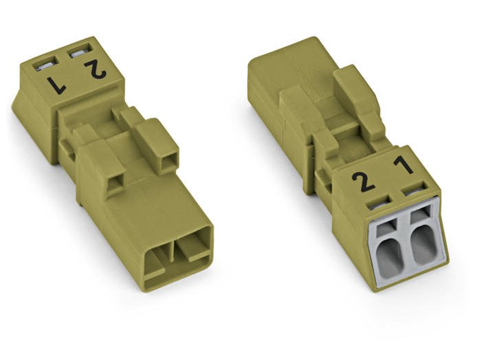

Штекер; 2-пол.; Код. B
Augswan
890-272
Wago
Wago 890-272
Actuation typeOperating tool Push-in
Clamping spring materialChrome nickel spring steel (CrNi)
CodingB
Цветlight green
Connection technologyPush-in CAGE CLAMP®
Connector connection typefor conductors
Contact materialCopper or copper alloy, surface-treated
Contact type (pluggable connector)Male connector/plug
Country of originPL
Degree of protectionIP20
Габариты: глубина34.1 mm / 1.343 inch
Fine-stranded conductor0.25 … 1.5 mm² / 22 … 16 AWG
Fine-stranded conductor with ferrule with plastic collar0.25 … 0.75 mm² / 22 … 20 AWG
Fine-stranded conductor with ferrule without plastic collar0.25 … 0.75 mm² / 22 … 20 AWG
Fine-stranded conductor with ferrule, push-in termination, from0.75 mm² / 20 AWG
Fire load0.056 MJ
Flammability class per UL94V0
GTIN4055143499637
Height11.7 mm / 0.461 inch
Insulating materialPolyamide 66 (PA 66)
Legend (ratings)(III / 3) ≙ Overvoltage category III / Pollution degree 3
Locking leverнет
Locking of plug-in connectionlocking lever
Marking1 2
Mating force of a plug-in connectionapprox. 20 … 70 N (depending on pole number)
Nominal cross section1.5 mm²
Note (strip length)see also packaging or instructions
Number of Poles2
Pin spacing4.4 mm (0.173 inch)
Potential marking1 2
Product Group20 (WINSTA)
Rated current16 A
Rated impulse voltage (III / 3)4 kV
Rated voltage (III / 3)250 В
Retention force of a plug-in connectionwhen locked: > 80N
Solid conductor0.25 … 1.5 mm² / 22 … 16 AWG
Solid conductor, push-in termination0.75 … 1.5 mm² / 20 … 16 AWG
Stranded conductor0.25 … 1 mm² / 22 … 18 AWG
Strip length9 mm / 0.35 Inch
Surrounding air (operating) temperature-35 … 85 °C
Total number of connection points2
Total number of potentials2
Unmating force of a plug-in connectionwhen unlocked: approx. 20 … 70 N (depending on pole number)
Вес2.474 г
Ширина10.4 mm / 0.409 inch
