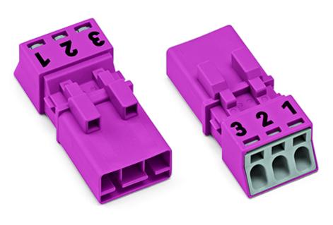

Actuation type | Operating tool Push-in |
Clamping spring material | Chrome nickel spring steel (CrNi) |
Coding | B |
Цвет | pink |
Connection technology | Push-in CAGE CLAMP® |
Connector connection type | for conductors |
Contact material | Copper or copper alloy, surface-treated |
Contact type (pluggable connector) | Male connector/plug |
Country of origin | PL |
Degree of protection | IP20 |
Габариты: глубина | 34.1 mm / 1.343 inch |
Fine-stranded conductor | 0.25 … 1.5 mm² / 22 … 16 AWG |
Fine-stranded conductor with ferrule with plastic collar | 0.25 … 0.75 mm² / 22 … 20 AWG |
Fine-stranded conductor with ferrule without plastic collar | 0.25 … 0.75 mm² / 22 … 20 AWG |
Fine-stranded conductor with ferrule, push-in termination, from | 0.75 mm² / 20 AWG |
Fire load | 0.047 MJ |
GTIN | 4055143500029 |
Height | 11.7 mm / 0.461 inch |
Legend (ratings) | (III / 3) ≙ Overvoltage category III / Pollution degree 3 |
Locking lever | нет |
Locking of plug-in connection | locking lever |
Marking | 1 2 5 |
Mating force of a plug-in connection | approx. 20 … 70 N (depending on pole number) |
Nominal cross section | 1.5 mm² |
Note (strip length) | see also packaging or instructions |
Note on rated current | 13 A for 3-pole load |
Number of Poles | 3 |
Pin spacing | 4.4 mm (0.173 inch) |
Potential marking | 1 2 5 |
Rated current | 16 A |
Rated impulse voltage (III / 3) | 4 kV |
Rated voltage (III / 3) | 250 В |
Retention force of a plug-in connection | when locked: > 80N |
Solid conductor | 0.25 … 1.5 mm² / 22 … 16 AWG |
Solid conductor, push-in termination | 0.75 … 1.5 mm² / 20 … 16 AWG |
Stranded conductor | 0.25 … 1 mm² / 22 … 18 AWG |
Strip length | 9 mm / 0.35 Inch |
Surrounding air (operating) temperature | -35 … 85 °C |
Total number of connection points | 3 |
Total number of potentials | 3 |
Unmating force of a plug-in connection | when unlocked: approx. 20 … 70 N (depending on pole number) |
Вес | 2.424 г |
Ширина | 15 mm / 0.591 inch |
