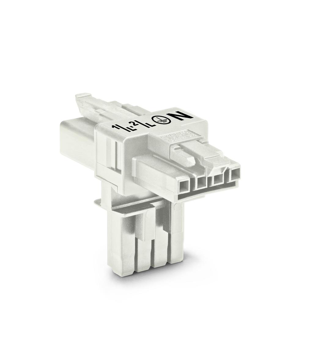

Т-образный распределительный соединитель; 1 штекер / 2 розетки; 4-пол.; 100% защита от неправильного подсоединения; съемные
T-DISTRIBUTION CONNECTOR 4-POLE | |||
890-676 Wago | по запросу |
Coding | A |
Цвет | white |
Contact material | Copper or copper alloy, surface-treated |
Contact type (pluggable connector) | Socket/plug |
Country of origin | DE |
Degree of protection | IP20 |
Габариты: глубина | 53.9 mm / 2.122 inch |
Fire load | 0.197 MJ |
GTIN | 4050821229568 |
Ground function | with preceding GND contact |
Height | 39.65 mm / 1.561 inch |
Legend (ratings) | (III / 3) ≙ Overvoltage category III / Pollution degree 3 |
Locking lever | да |
Locking of plug-in connection | locking lever |
Marking | N ⏚ 2|L 1|L' |
Mating force of a plug-in connection | approx. 20 … 70 N (depending on pole number) |
Mismating protection | Yes |
Number of Poles | 4 |
Pin spacing | 4.4 mm (0.173 inch) |
Potential marking | N ⏚ 2/L 1/L' |
Product Group | 20 (WINSTA) |
Rated current | 16 A |
Rated impulse voltage (III / 3) | 6 kV |
Rated voltage (III / 3) | 400 В |
Retention force of a plug-in connection | when locked: > 80N |
Surrounding air (operating) temperature | -35 … 85 °C |
Total number of potentials | 4 |
Type of distribution connector | T-distribution connector |
Unmating force of a plug-in connection | when unlocked: approx. 20 … 70 N (depending on pole number) |
Вес | 10.232 г |
Ширина | 22.3 mm / 0.878 inch |
