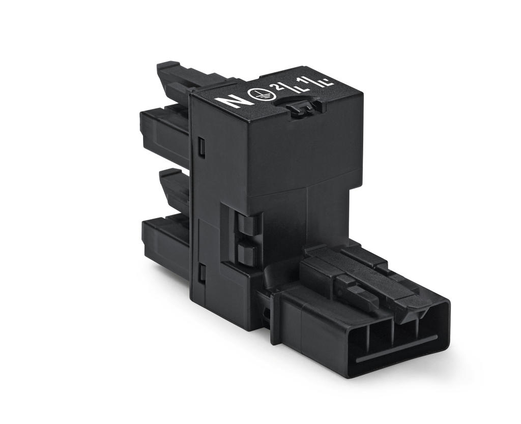

Ч-образный распределительный соединитель; 1 штекер / 2 розетки; 4-пол.; для тонких проволочных выводов; с третьим фиксирующим рычагом; 100% защита от неправильного подсоединения; съемные; с возможностью присоединения к розетке на стороне вывода
H-DISTRIBUTION CONNECTOR 4-POLE | |||
| 890-945 Wago | по запросу | ||
| Coding | A |
| Цвет | black |
| Contact material | Copper or copper alloy, surface-treated |
| Contact type (pluggable connector) | Socket/plug |
| Country of origin | DE |
| Degree of protection | IP20 |
| Габариты: глубина | 57.85 mm / 2.278 inch |
| Fire load | 0.314 MJ |
| Flammability class per UL94 | V0 |
| GTIN | 4050821255161 |
| Ground function | with preceding GND contact |
| Height | 32.65 mm / 1.285 inch |
| Insulating material | Polyamide 66 (PA 66) |
| Legend (ratings) | (III / 3) ≙ Overvoltage category III / Pollution degree 3 |
| Locking lever | да |
| Locking of plug-in connection | locking lever |
| Marking | N ⏚ 2|L 1|L' |
| Mating force of a plug-in connection | approx. 20 … 70 N (depending on pole number) |
| Mismating protection | Yes |
| Number of Poles | 4 |
| Pin spacing | 4.4 mm (0.173 inch) |
| Potential marking | N ⏚ 2/L 1/L' |
| Product Group | 20 (WINSTA) |
| Rated current | 16 A |
| Rated impulse voltage (III / 3) | 6 kV |
| Rated voltage (III / 3) | 400 В |
| Retention force of a plug-in connection | when locked: > 80N |
| Surrounding air (operating) temperature | -35 … 85 °C |
| Total number of potentials | 4 |
| Type of distribution connector | h-distribution connector, unidirectional |
| Unmating force of a plug-in connection | when unlocked: approx. 20 … 70 N (depending on pole number) |
| Вес | 19.344 г |
| Ширина | 20.8 mm / 0.819 inch |
