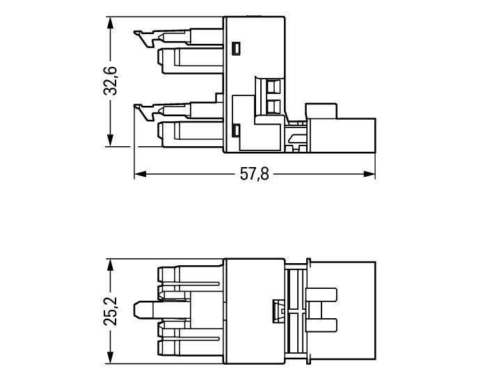

Datasheet Wago 890-979 — Даташит
Ч-образный распределительный соединитель; 1 штекер / 2 розетки; 5-пол.; 100% защита от неправильного подсоединения; съемные; с возможностью присоединения к розетке на стороне вывода
8.90979e+007 | по запросу |
Coding | A |
Цвет | white |
Contact material | Copper or copper alloy, surface-treated |
Contact type (pluggable connector) | Socket/plug |
Country of origin | DE |
Degree of protection | IP20 |
Габариты: глубина | 57.85 mm / 2.278 inch |
Fire load | 0.358 MJ |
GTIN | 4050821255130 |
Height | 32.65 mm / 1.285 inch |
Legend (ratings) | (III / 3) ≙ Overvoltage category III / Pollution degree 3 |
Locking lever | да |
Locking of plug-in connection | locking lever |
Marking | N ⏚ 1 2 3 |
Mating force of a plug-in connection | approx. 20 … 70 N (depending on pole number) |
Mismating protection | Yes |
Number of Poles | 5 |
Pin spacing | 4.4 mm (0.173 inch) |
Potential marking | N ⏚ 1 2 3 |
Product Group | 20 (WINSTA) |
Rated current | 13 A |
Rated impulse voltage (III / 3) | 6 kV |
Rated voltage (III / 3) | 400 В |
Retention force of a plug-in connection | when locked: > 80N |
Surrounding air (operating) temperature | -35 … 85 °C |
Total number of potentials | 5 |
Type of distribution connector | h-distribution connector, unidirectional |
Unmating force of a plug-in connection | when unlocked: approx. 20 … 70 N (depending on pole number) |
Вес | 23.013 г |
Ширина | 25.2 mm / 0.992 inch |
