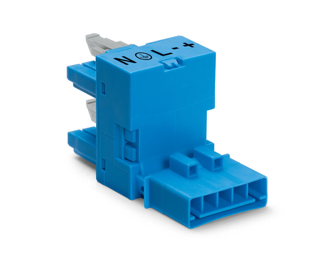

Ч-образный распределительный соединитель; 1 штекер / 2 розетки; 5-пол.; 100% защита от неправильного подсоединения; съемные; с возможностью присоединения к розетке на стороне вывода
| H-DISTRIBUTION CONNECTOR5-POLE COD. I, BLUE | |||
| 890-982 Wago | по запросу | ||
| Coding | I |
| Цвет | blue |
| Contact material | Copper or copper alloy, surface-treated |
| Contact type (pluggable connector) | Socket/plug |
| Country of origin | DE |
| Degree of protection | IP20 |
| Габариты: глубина | 57.85 mm / 2.278 inch |
| Fire load | 0.356 MJ |
| Flammability class per UL94 | V0 |
| GTIN | 4050821300328 |
| Ground function | with preceding GND contact |
| Height | 32.65 mm / 1.285 inch |
| Insulating material | Polyamide 66 (PA 66) |
| Legend (ratings) | (III / 3) ≙ Overvoltage category III / Pollution degree 3 |
| Locking lever | да |
| Locking of plug-in connection | locking lever |
| Marking | N ⏚ L - + |
| Mating force of a plug-in connection | approx. 20 … 70 N (depending on pole number) |
| Mismating protection | Yes |
| Number of Poles | 5 |
| Pin spacing | 4.4 mm (0.173 inch) |
| Potential marking | N ⏚ L - + |
| Product Group | 20 (WINSTA) |
| Rated current | 16 A |
| Rated impulse voltage (III / 3) | 6 kV |
| Rated voltage (III / 3) | 400 В |
| Retention force of a plug-in connection | when locked: > 80N |
| Surrounding air (operating) temperature | -35 … 85 °C |
| Total number of potentials | 5 |
| Type of distribution connector | h-distribution connector, unidirectional |
| Unmating force of a plug-in connection | when unlocked: approx. 20 … 70 N (depending on pole number) |
| Вес | 22.943 г |
| Ширина | 25.2 mm / 0.992 inch |
