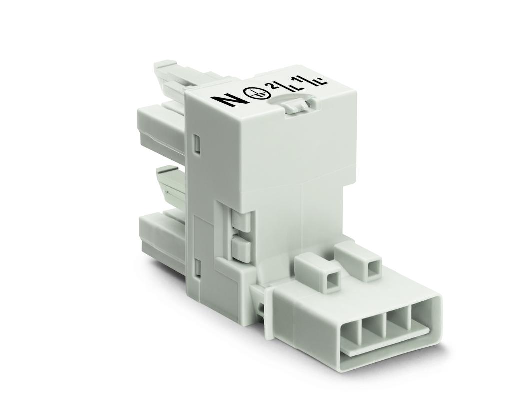

Ч-образный распределительный соединитель; 1 штекер / 2 розетки; 4-пол.; 100% защита от неправильного подсоединения; съемные; с возможностью присоединения к розетке на стороне вывода
Augswan
890-994
Wago
Wago 890-994
CodingA
Цветwhite
Contact materialCopper or copper alloy, surface-treated
Contact type (pluggable connector)Socket/plug
Country of originDE
Degree of protectionIP20
Габариты: глубина57.85 mm / 2.278 inch
Fire load0.303 MJ
Flammability class per UL94V0
GTIN4050821255178
Ground functionwith preceding GND contact
Height32.65 mm / 1.285 inch
Insulating materialPolyamide 66 (PA 66)
Legend (ratings)(III / 3) ≙ Overvoltage category III / Pollution degree 3
Locking leverда
Locking of plug-in connectionlocking lever
MarkingN ⏚ 2|L 1|L'
Mating force of a plug-in connectionapprox. 20 … 70 N (depending on pole number)
Mismating protectionYes
Number of Poles4
Pin spacing4.4 mm (0.173 inch)
Potential markingN ⏚ 2/L 1/L'
Product Group20 (WINSTA)
Rated current16 A
Rated impulse voltage (III / 3)6 kV
Rated voltage (III / 3)400 В
Retention force of a plug-in connectionwhen locked: > 80N
Surrounding air (operating) temperature-35 … 85 °C
Total number of potentials4
Type of distribution connectorh-distribution connector, unidirectional
Unmating force of a plug-in connectionwhen unlocked: approx. 20 … 70 N (depending on pole number)
Вес18.984 г
Ширина20.8 mm / 0.819 inch
