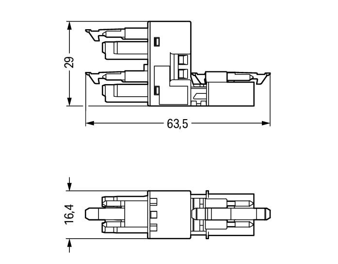

Ч-образный распределительный соединитель; однонаправленные; 1 штекер / 2 розетки; 3-пол.; для тонких проволочных выводов; с третьим фиксирующим рычагом; 100% защита от неправильного подсоединения; съемные
H-DISTRIBUTION CONNECTOR 3-POLE | |||
890-1761 Wago | по запросу |
Coding | B |
Цвет | gray |
Contact material | Copper or copper alloy, surface-treated |
Contact type (pluggable connector) | Socket/plug |
Country of origin | DE |
Degree of protection | IP20 |
Габариты: глубина | 57.85 mm / 2.278 inch |
Fire load | 0.25 MJ |
GTIN | 4050821530732 |
Height | 29 mm / 1.142 inch |
Legend (ratings) | (III / 3) ≙ Overvoltage category III / Pollution degree 3 |
Locking lever | да |
Locking of plug-in connection | locking lever |
Marking | 1 2 3 |
Mating force of a plug-in connection | approx. 20 … 70 N (depending on pole number) |
Number of Poles | 3 |
Pin spacing | 4.4 mm (0.173 inch) |
Potential marking | 1 2 3 |
Product Group | 20 (WINSTA) |
Rated current | 16 A |
Rated impulse voltage (III / 3) | 4 kV |
Rated voltage (III / 3) | 250 В |
Retention force of a plug-in connection | when locked: > 80N |
Surrounding air (operating) temperature | -35 … 85 °C |
Total number of potentials | 3 |
Type of distribution connector | h-distribution connector, unidirectional |
Unmating force of a plug-in connection | when unlocked: approx. 20 … 70 N (depending on pole number) |
Вес | 13.913 г |
Ширина | 16.4 mm / 0.646 inch |
