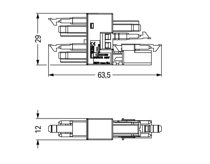

3-канальный распр. соединитель; 2-пол.; Кодирование I; 1 вход; 3 вывода; выходы с обеих сторон
Augswan
890-1904
Wago
Wago 890-1904
CodingI
Цветblue
Contact materialCopper or copper alloy, surface-treated
Contact type (pluggable connector)Socket/plug
Country of originDE
Degree of protectionIP20
Габариты: глубина63.5 mm / 2.5 inch
Flammability class per UL94V0
GTIN4055143608718
Height29 mm / 1.142 inch
Insulating materialPolyamide 66 (PA 66)
Legend (ratings)(III / 3) ≙ Overvoltage category III / Pollution degree 3
Locking leverда
Locking of plug-in connectionlocking lever
Marking+ -
Mating force of a plug-in connectionapprox. 20 … 70 N (depending on pole number)
Mismating protectionYes
Number of Poles2
Pin spacing4.4 mm (0.173 inch)
Potential marking+ -
Rated current16 A
Rated impulse voltage (III / 3)4 kV
Rated voltage (III / 3)250 В
Retention force of a plug-in connectionwhen locked: > 80N
Surrounding air (operating) temperature-35 … 85 °C
Total number of potentials2
Type of distribution connectorDistribution connector, 3-way
Unmating force of a plug-in connectionwhen unlocked: approx. 20 … 70 N (depending on pole number)
Вес11.924 г
Ширина12 mm / 0.472 inch
