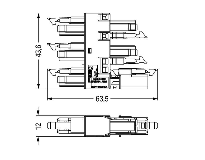

Datasheet Wago 890-1907 — Даташит
5-канальный распр. соединитель; 2-пол.; Кодирование I; 1 вход; 5 вывода; выходы с обеих сторон
Coding | I |
Цвет | blue |
Contact material | Copper or copper alloy, surface-treated |
Contact type (pluggable connector) | Socket/plug |
Country of origin | DE |
Degree of protection | IP20 |
Габариты: глубина | 63.5 mm / 2.5 inch |
GTIN | 4055143609043 |
Height | 43.6 mm / 1.717 inch |
Legend (ratings) | (III / 3) ≙ Overvoltage category III / Pollution degree 3 |
Locking lever | да |
Locking of plug-in connection | locking lever |
Marking | + - |
Mating force of a plug-in connection | approx. 20 … 70 N (depending on pole number) |
Mismating protection | Yes |
Number of Poles | 2 |
Pin spacing | 4.4 mm (0.173 inch) |
Potential marking | + - |
Rated current | 16 A |
Rated impulse voltage (III / 3) | 4 kV |
Rated voltage (III / 3) | 250 В |
Retention force of a plug-in connection | when locked: > 80N |
Surrounding air (operating) temperature | -35 … 85 °C |
Total number of potentials | 2 |
Type of distribution connector | Distribution connector, 5-way |
Unmating force of a plug-in connection | when unlocked: approx. 20 … 70 N (depending on pole number) |
Вес | 17.896 г |
Ширина | 12 mm / 0.472 inch |
