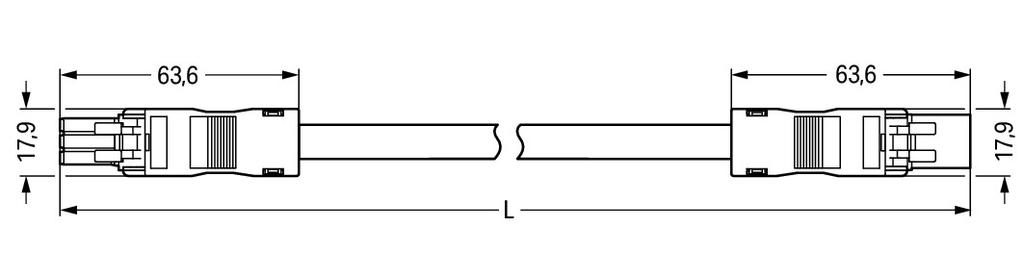

Соединительный кабель; Розетка - штекер; 3-пол.; длиной 5 м; Кодирование А; с изоляцией из ПВХ
891-8993/006-701 Wago | по запросу |
Coding | A |
Цвет | white |
Color of sheathed cable | white |
Connection type | Socket - Plug |
Connector color | white |
Contact material | Copper or copper alloy, surface-treated |
Country of origin | PL |
Cross section of single conductor | 1.5 mm² |
Degree of protection | IP20 |
Durchmesser der Mantelleitung | 7.4 … 9.4 mm |
Fire load | 9.807 MJ |
GTIN | 4055143396820 |
Ground function | with preceding GND contact |
Legend (ratings) | (III / 3) ≙ Overvoltage category III / Pollution degree 3 |
Locking lever | нет |
Locking of plug-in connection | locking lever |
Marking | L ⏚ N |
Mating force of a plug-in connection | approx. 20 … 70 N (depending on pole number) |
Mismating protection | Yes |
Number of Poles | 3 |
Pin spacing | 4.4 mm (0.173 inch) |
Potential marking | L ⏚ N |
Printing color of mating face | black |
Printing color of sheathed cable | black |
Printing color of strain relief | black |
Rated current | 16 A |
Rated impulse voltage (III / 3) | 4 kV |
Rated voltage (III / 3) | 250 В |
Reaction to fire class per EN 50575 | Eca |
Retention force of a plug-in connection | when locked: > 80N |
Sheath material | PVC |
Strain relief color | white |
Surrounding air (operating) temperature | -35 … 85 °C |
Total length | 5 m |
Total number of potentials | 3 |
Type of cable | H05VV-F 3G1.5 |
Type of cable assembly | Interconnecting cable |
Unmating force of a plug-in connection | when unlocked: approx. 20 … 70 N (depending on pole number) |
Вес | 548.648 г |
