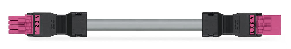

Datasheet Wago 891-8994/005-707 — Даташит
Соединительный кабель; Розетка - штекер; 4-пол.; Кодирование B; длиной 7 м; с изоляцией из ПВХ
891-8994/005-507 Wago | по запросу |
Coding | B |
Цвет | pink |
Color of sheathed cable | gray |
Connection type | Socket - Plug |
Connector color | pink |
Contact material | Copper or copper alloy, surface-treated |
Country of origin | DE |
Cross section of single conductor | 1 mm² |
Degree of protection | IP20 |
Durchmesser der Mantelleitung | 7.1 … 9 mm |
GTIN | 4055143516310 |
Legend (ratings) | (III / 3) ≙ Overvoltage category III / Pollution degree 3 |
Locking lever | нет |
Locking of plug-in connection | locking lever |
Marking | 1 2 3 4 |
Mating force of a plug-in connection | approx. 20 … 70 N (depending on pole number) |
Number of Poles | 4 |
Pin spacing | 4.4 mm (0.173 inch) |
Potential marking | 1 2 3 4 |
Printing color of mating face | black |
Printing color of sheathed cable | black |
Printing color of strain relief | white |
Rated current | 10 A |
Rated impulse voltage (III / 3) | 6 kV |
Rated voltage (III / 3) | 400 В |
Retention force of a plug-in connection | when locked: > 80N |
Sheath material | PVC |
Strain relief color | black |
Surrounding air (operating) temperature | -35 … 85 °C |
Total length | 7 m |
Total number of potentials | 4 |
Type of cable | Control line 4 x 1 |
Type of cable assembly | Interconnecting cable |
Unmating force of a plug-in connection | when unlocked: approx. 20 … 70 N (depending on pole number) |
Вес | 578.153 г |
