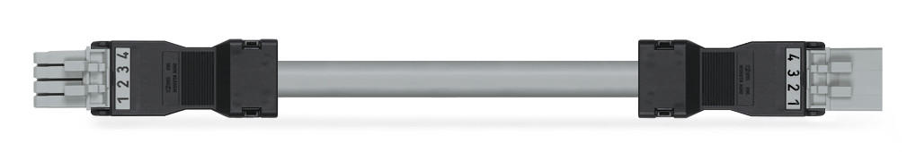

Соединительный кабель; Розетка - штекер; 4-пол.; Кодирование B; длиной 8 м; с изоляцией из ПВХ
| 891-8994/005-507 Wago | по запросу | ||
| Coding | B |
| Цвет | gray |
| Color of sheathed cable | gray |
| Connection type | Socket - Plug |
| Connector color | gray |
| Contact material | Copper or copper alloy, surface-treated |
| Country of origin | DE |
| Cross section of single conductor | 1 mm² |
| Degree of protection | IP20 |
| Durchmesser der Mantelleitung | 7.1 … 9 mm |
| Fire load | 10.474 MJ |
| Flammability class per UL94 | V0 |
| GTIN | 4050821295549 |
| Insulating material | Polyamide 66 (PA 66) |
| Legend (ratings) | (III / 3) ≙ Overvoltage category III / Pollution degree 3 |
| Locking lever | нет |
| Locking of plug-in connection | locking lever |
| Marking | 1 2 3 4 |
| Mating force of a plug-in connection | approx. 20 … 70 N (depending on pole number) |
| Number of Poles | 4 |
| Pin spacing | 4.4 mm (0.173 inch) |
| Potential marking | 1 2 3 4 |
| Printing color of mating face | black |
| Printing color of sheathed cable | black |
| Printing color of strain relief | white |
| Rated current | 10 A |
| Rated impulse voltage (III / 3) | 6 kV |
| Rated voltage (III / 3) | 400 В |
| Retention force of a plug-in connection | when locked: > 80N |
| Sheath material | PVC |
| Strain relief color | black |
| Surrounding air (operating) temperature | -35 … 85 °C |
| Total length | 8 m |
| Total number of potentials | 4 |
| Type of cable | Control line 4 x 1 |
| Type of cable assembly | Interconnecting cable |
| Unmating force of a plug-in connection | when unlocked: approx. 20 … 70 N (depending on pole number) |
| Вес | 657.86 г |
