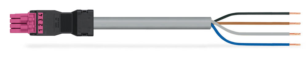

Соединительный кабель; Розетка - свободный конец; 4-пол.; Кодирование B; длиной 2 м; с изоляцией из ПВХ
Maybo
891-8994/105-705
Wago
Wago 891-8994/105-207
CodingB
Цветpink
Color of sheathed cablegray
Conductor preparationtip-bonded
Connection typeSocket - free end
Connector colorpink
Contact materialCopper or copper alloy, surface-treated
Country of originDE
Cross section of single conductor1 mm²
Degree of protectionIP20
Durchmesser der Mantelleitung7.1 … 9 mm
Flammability class per UL94V0
GTIN4055143516631
Insulating materialPolyamide 66 (PA 66)
Legend (ratings)(III / 3) ≙ Overvoltage category III / Pollution degree 3
Locking leverнет
Locking of plug-in connectionlocking lever
Marking1 2 3 4
Mating force of a plug-in connectionapprox. 20 … 70 N (depending on pole number)
Number of Poles4
Pin spacing4.4 mm (0.173 inch)
Potential marking1 2 3 4
Printing color of mating faceblack
Printing color of sheathed cableblack
Printing color of strain reliefwhite
Rated current10 A
Rated impulse voltage (III / 3)6 kV
Rated voltage (III / 3)400 В
Retention force of a plug-in connectionwhen locked: > 80N
Sheath materialPVC
Strain relief colorblack
Strip length38 мм
Surrounding air (operating) temperature-35 … 85 °C
Total length2 m
Total number of potentials4
Type of cableControl line 4 x 1
Type of cable assemblyConnecting cable
Unmating force of a plug-in connectionwhen unlocked: approx. 20 … 70 N (depending on pole number)
