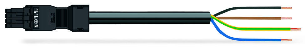

Соединительный кабель; Розетка - свободный конец; 4-пол.; длиной 1 м; Кодирование А; с изоляцией из ПВХ; Концы проводников, припаянные: 9 мм
891-8994/106-805 Wago | по запросу |
Coding | A |
Цвет | black |
Color of sheathed cable | black |
Conductor preparation | tip-bonded |
Connection type | Socket - free end |
Connector color | black |
Contact material | Copper or copper alloy, surface-treated |
Country of origin | PL |
Cross section of single conductor | 1.5 mm² |
Degree of protection | IP20 |
Durchmesser der Mantelleitung | 8.4 … 10.5 mm |
Fire load | 2.402 MJ |
GTIN | 4055143403931 |
Ground function | with preceding GND contact |
Legend (ratings) | (III / 3) ≙ Overvoltage category III / Pollution degree 3 |
Locking lever | нет |
Locking of plug-in connection | locking lever |
Marking | N ⏚ 2|L 1|L' |
Mating force of a plug-in connection | approx. 20 … 70 N (depending on pole number) |
Mismating protection | Yes |
Number of Poles | 4 |
Pin spacing | 4.4 mm (0.173 inch) |
Potential marking | N ⏚ 2/L 1/L' |
Printing color of mating face | white |
Printing color of sheathed cable | white |
Printing color of strain relief | white |
Rated current | 16 A |
Rated impulse voltage (III / 3) | 6 kV |
Rated voltage (III / 3) | 400 В |
Reaction to fire class per EN 50575 | Eca |
Retention force of a plug-in connection | when locked: > 80N |
Sheath material | PVC |
Strain relief color | black |

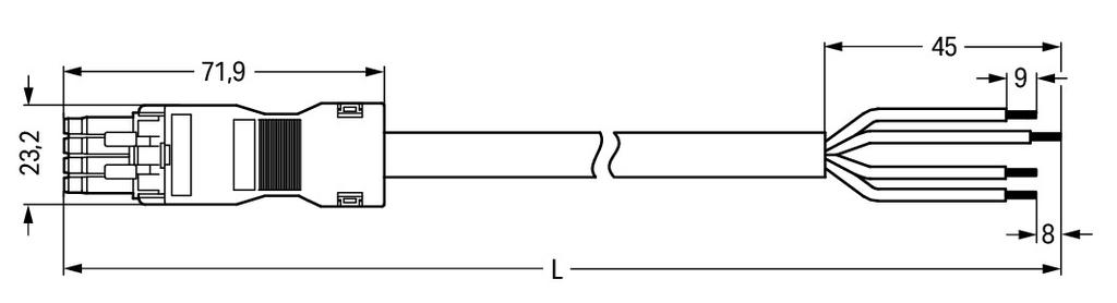

Strip length | 45 мм |
Surrounding air (operating) temperature | -35 … 85 °C |
Total length | 1 m |
Total number of potentials | 4 |
Type of cable | H05VV-F 4G1.5 |
Type of cable assembly | Connecting cable |
Unmating force of a plug-in connection | when unlocked: approx. 20 … 70 N (depending on pole number) |
Вес | 142.458 г |
