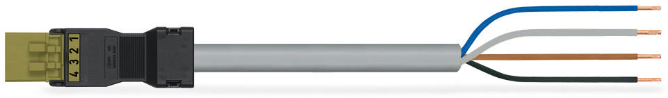

Datasheet Wago 891-8994/206-605 — Даташит
Соединительный кабель; Штекер - свободный конец; 4-пол.; Кодирование B; длиной 6 м; с изоляцией из ПВХ
891-8994/206-705 Wago | по запросу |
Coding | B |
Цвет | light green |
Color of sheathed cable | gray |
Conductor preparation | tip-bonded |
Connection type | Plug - free end |
Connector color | light green |
Contact material | Copper or copper alloy, surface-treated |
Country of origin | DE |
Cross section of single conductor | 1.5 mm² |
Degree of protection | IP20 |
Durchmesser der Mantelleitung | 8.4 … 10.5 mm |
GTIN | 4055143520379 |
Legend (ratings) | (III / 3) ≙ Overvoltage category III / Pollution degree 3 |
Locking lever | нет |
Locking of plug-in connection | locking lever |
Marking | 1 2 3 4 |
Mating force of a plug-in connection | approx. 20 … 70 N (depending on pole number) |
Note on rated current | 13 A for 3-pole load10 A for 4-pole load |
Number of Poles | 4 |
Pin spacing | 4.4 mm (0.173 inch) |
Potential marking | 1 2 3 4 |
Printing color of mating face | black |
Printing color of sheathed cable | black |
Printing color of strain relief | white |
Rated current | 16 A |
Rated impulse voltage (III / 3) | 6 kV |
Rated voltage (III / 3) | 400 В |
Retention force of a plug-in connection | when locked: > 80N |
Sheath material | PVC |
Strain relief color | black |
Strip length | 38 мм |
Surrounding air (operating) temperature | -35 … 85 °C |
Total length | 6 m |
Total number of potentials | 4 |
Type of cable | Control line 4 x 1.5 |
Type of cable assembly | Connecting cable |
Unmating force of a plug-in connection | when unlocked: approx. 20 … 70 N (depending on pole number) |
Вес | 662.338 г |
