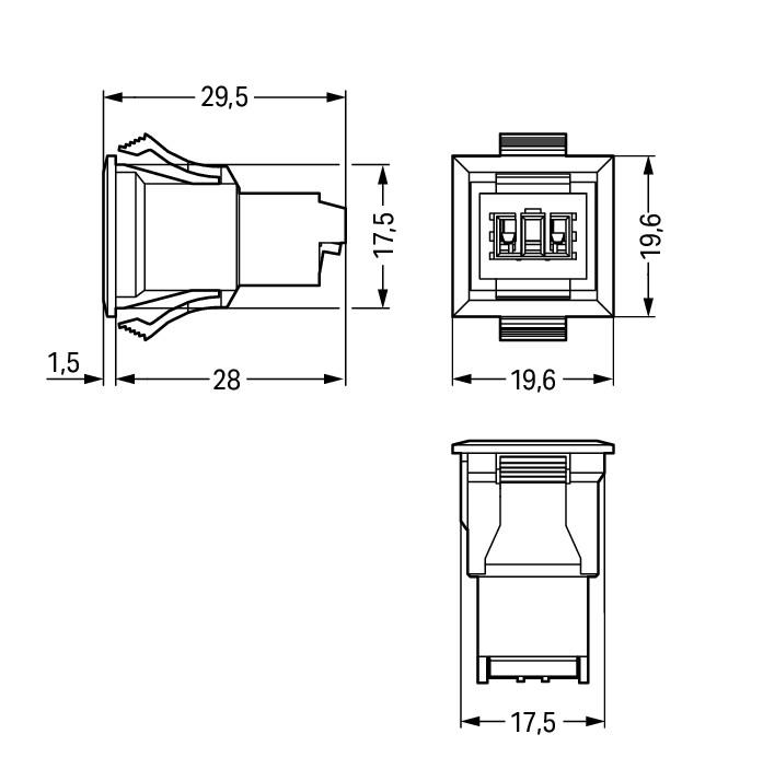

Actuation typePush-in
CodingE
Цветgreen
Conductor diameter0.8
Connection technologyPUSH WIRE®
Connector connection typefor conductors
Contact materialCopper alloy, surface-treated
Contact type (pluggable connector)Female connector/socket
Country of originCH
Degree of protectionIP20
Габариты: глубина29.5 mm / 1.161 inch
Flammability class per UL94V0
GTIN4045454420130
Gehäuseblechstärke0.5 … 2 mm / 0.02 … 0.079 inch
Height19.6 mm / 0.772 inch
Insulating materialPolyamide 66 (PA 66)
Legend (ratings)(III / 3) ≙ Overvoltage category III / Pollution degree 3
Marking1+ 2-
Mating force of a plug-in connectionapprox. 10–15N
Mismating protectionYes
Mounting typeSnap-in
Note (strip length)see also packaging or instructions
Number of Poles2
Potential marking1+ 2-
Product Group20 (WINSTA)
Rated current3 A
Rated impulse voltage (III / 3)0.8 kV
Rated voltage (III / 3)50 В
Reaction to fire class per EN 50575Eca
Strip length9 mm / 0.35 Inch
Surrounding air (operating) temperature-35 … 85 °C
Total number of connection points2
Total number of potentials2
Unmating force of a plug-in connectionwhen unlocked: approx. 15–20N
Вес3.6 г
Ширина19.6 mm / 0.772 inch
