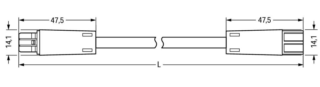

Datasheet Wago 894-8992/023-506 — Даташит
предв. собранный межблочный кабель; Eca; Розетка - штекер; 2-пол.; Код. E; J-Y(ST)Y…LG 2x2x0,8; 5 м
894-8992/223-106 Wago | по запросу |
Coding | E |
Цвет | green |
Color of sheathed cable | green |
Conductor diameter | 0.8 … 0.8 mm |
Connection type | Socket - Plug |
Connector color | green |
Contact material | Copper alloy, surface-treated |
Country of origin | PL |
Degree of protection | IP20 |
Fire load | 4.663 MJ |
GTIN | 4055143306737 |
Legend (ratings) | (III / 3) ≙ Overvoltage category III / Pollution degree 3 |
Locking of plug-in connection | locking lever |
Marking | 1+ 2- |
Mating force of a plug-in connection | approx. 10 … 15 N |
Mismating protection | Yes |
Number of Poles | 2 |
Potential marking | 1+ 2- |
Rated current | 3 A |
Rated impulse voltage (III / 3) | 0.8 kV |
Rated voltage (III / 3) | 50 В |
Sheath material | PVC |
Strain relief color | black |
Surrounding air (operating) temperature | -35 … 85 °C |
Total length | 5 m |
Total number of potentials | 2 |
Type of cable | UNITRONIC BUS EIB 2x2x0.8 |
Type of cable assembly | Interconnecting cable |
Unmating force of a plug-in connection | when unlocked: approx. 15 … 20 N |
Вес | 280.7 г |
