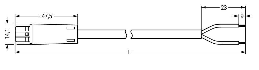

предв. собранный соединительный кабель; Eca; Розетка/открытая; 2-пол.; Код. E; J-Y(ST)Y…LG 2x2x0,8; 3 м
| 894-8992/133-506 Wago | по запросу | ||
| Coding | E |
| Цвет | green |
| Color of sheathed cable | green |
| Conductor diameter | 0.8 … 0.8 mm |
| Connection type | Socket - free end |
| Connector color | green |
| Contact material | Copper alloy, surface-treated |
| Country of origin | PL |
| Degree of protection | IP20 |
| Fire load | 2.757 MJ |
| Flammability class per UL94 | V0 |
| GTIN | 4055143306843 |
| Insulating material | Polyamide 66 (PA 66) |
| Legend (ratings) | (III / 3) ≙ Overvoltage category III / Pollution degree 3 |
| Locking of plug-in connection | locking lever |
| Marking | 1+ 2- |
| Mating force of a plug-in connection | approx. 10 … 15 N |
| Mismating protection | Yes |
| Number of Poles | 2 |
| Rated current | 3 A |
| Rated impulse voltage (III / 3) | 0.8 kV |
| Rated voltage (III / 3) | 50 В |
| Sheath material | PVC |
| Strain relief color | black |
| Strip length | 23 мм |
| Surrounding air (operating) temperature | -35 … 85 °C |
| Total length | 3 m |
| Total number of potentials | 2 |
| Type of cable | UNITRONIC BUS EIB 2x2x0.8 |
| Type of cable assembly | Connecting cable |
| Unmating force of a plug-in connection | when unlocked: approx. 15 … 20 N |
| Вес | 166.784 г |
