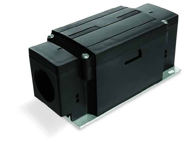

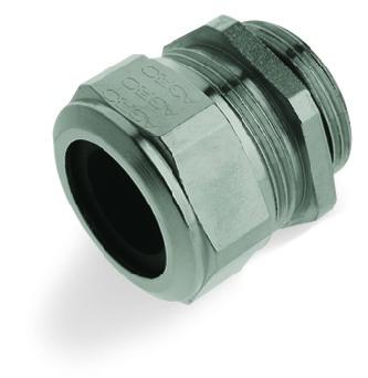

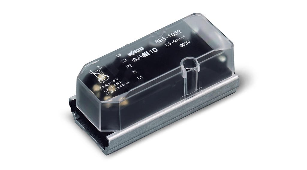

Actuation typeOperating toolOperating toolOperating toolOperating tool
Цветtransparenttransparentwhiteblackgraygraysilver-coloredblackblackblack
Connection technologyPush-in CAGE CLAMP®CAGE CLAMP®Screw clamp connectionScrew clamp connection
Connection technology 2IDC connectionIDC connection
Contact materialCopper or copper alloy, surface-treatedCopper or copper alloy, surface-treatedCopper or copper alloy, surface-treatedCopper or copper alloy, surface-treated
Country of originDECHCHCHCHCHCHCHCHCH
Degree of protectionIP20IP20IP 20 without cable gland/filler plugIP 65 with cable gland/filler plugIP 20 without cable gland/filler plugIP 65 with cable gland/filler plug

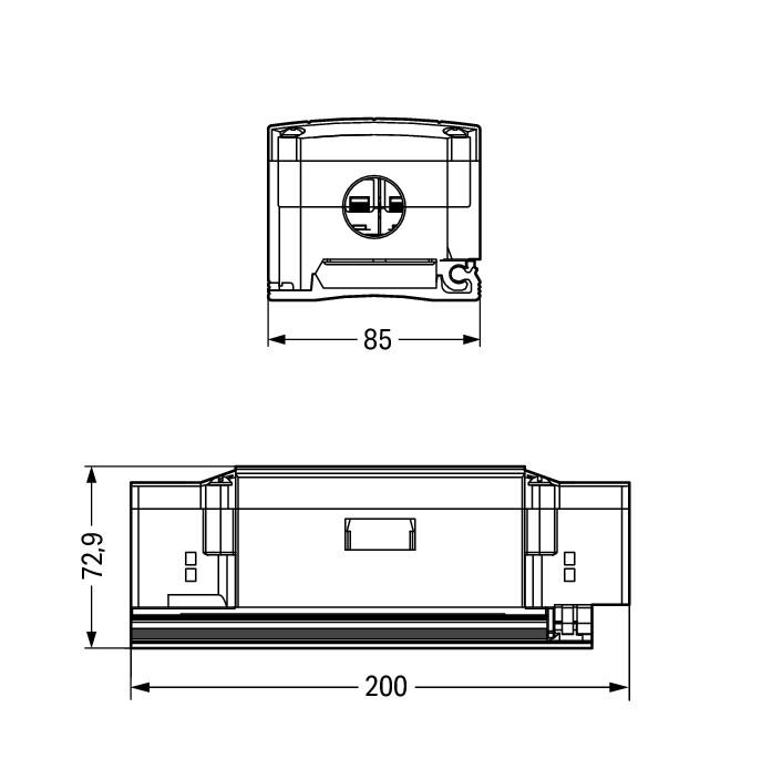

Габариты: глубина160 mm / 6.299 inch110 mm / 4.331 inch27 mm / 1.063 inch200 mm / 7.874 inch200 mm / 7.874 inch
Fire load, MJ2.2322.70.7240.6480.25211.8810.692
Flammability class per UL94V0V0V0V0V0V0V0V0V0V0
GTIN4045454006259404545400626640454541928844045454006433404545400644040454540064574045454006464404545400647140454540063894045454006396
Height65 mm / 2.559 inch48 mm / 1.89 inch1 mm / 0.039 inch90 mm / 3.543 inch73 mm / 2.874 inch
Insulating materialPolyamide 66 (PA 66)Polyamide 66 (PA 66)Polyamide 66 (PA 66)Polyamide 66 (PA 66)
Legend (ratings)(III / 3) ≙ Overvoltage category III / Pollution degree 3(III / 3) ≙ Overvoltage category III / Pollution degree 3(III / 3) ≙ Overvoltage category III / Pollution degree 3(III / 3) ≙ Overvoltage category III / Pollution degree 3(III / 3) ≙ Overvoltage category III / Pollution degree 3(III / 3) ≙ Overvoltage category III / Pollution degree 3(III / 3) ≙ Overvoltage category III / Pollution degree 3(III / 3) ≙ Overvoltage category III / Pollution degree 3(III / 3) ≙ Overvoltage category III / Pollution degree 3(III / 3) ≙ Overvoltage category III / Pollution degree 3
Mating force of a plug-in connectionapprox. 30–70N (depending on number of poles)approx. 30–70N (depending on number of poles)approx. 30–70N (depending on number of poles)approx. 30–70N (depending on number of poles)
Mismating protectionYesYesYesYes
Product Group20 (WINSTA)20 (WINSTA)20 (WINSTA)20 (WINSTA)20 (WINSTA)20 (WINSTA)20 (WINSTA)20 (WINSTA)20 (WINSTA)20 (WINSTA)
Rated current, A57327641
Rated impulse voltage (III / 3), kV8888
Rated voltage (III / 3), В750690690690
Surrounding air (operating) temperature-35 … 85 °C-35 … 85 °C-35 … 85 °C-35 … 85 °C-35 … 85 °C-35 … 85 °C-35 … 85 °C-35 … 85 °C-35 … 85 °C-35 … 85 °C
Total number of connection points5555
Total number of potentials5555
Unmating force of a plug-in connectionwhen unlocked: approx. 15–20Nwhen unlocked: approx. 15–20Nwhen unlocked: approx. 15–20Nwhen unlocked: approx. 15–20N
Вес, г450171.80.5475.810010010010.8872.9750.7
Ширина90 mm / 3.543 inch51 mm / 2.008 inch12 mm / 0.472 inch85 mm / 3.346 inch85 mm / 3.346 inch
