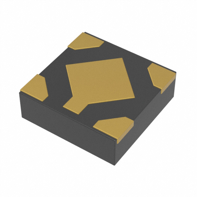

Статус
Статус продукта | В производстве (Рекомендуется для новых разработок) |
Код корпуса производителя | DFN5B |
Application | Mobile equipment / Camera/Sensor power supply / RF power supply |
Assembly bases | Japan |
Auto-discharge | Y |
Dropout Voltage (Typ.) [IOUT=0.5A] | 100 мВ |
Основные особенности | Low dropout voltage / High ripple rejection ratio / Fast load transient response / Small package |
Inrush current reduction | Y |
Operating Input Voltage | VOUT+VDO to VBIAS В |
Operating Output Current (Max) | 500 мА |
Operating Temperature | -40 to 85 ℃ |
Output Capacitance | ≥2.2 μF |
Output Noise Voltage (Typ.) | 40 μVrms |
Тип выхода | Fixed Output |
Output Voltage (Typ.) | 1.05 В |
Output Voltage Accuracy (±) | 1.0 % |
Output Voltage Lineup | 0.8 to 3.6 В |
Overcurrent protection | Y |
Quiescent Current (Typ.) [IOUT=0mA] | 19 μA |
Ripple Rejection Ratio (Typ.) [f=1kHz] | 98 дБ |
Stand-by Current (Typ.) | 0.1 μA |
Thermal shutdown | Y |
