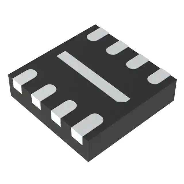

| Корпус | 8-Lead DFN (2mm x 2mm w/ EP) | 8-Lead DFN (2mm x 2mm w/ EP) | 8-Lead DFN (2mm x 2mm w/ EP) | 8-Lead DFN (2mm x 2mm w/ EP) |
| Количество выводов | 8 | 8 | 8 | 8 |
| Код корпуса | 05-08-1957 | 05-08-1957 | 05-08-1957 | 05-08-1957 |
