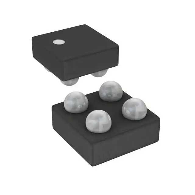

Количество выводов4
Код корпуса производителяWCSP4F
Способ монтажаSurface Mount
Ширина×Длина×Высота0.645×0.645×0.33 мм
ApplicationMobile equipment / IOT/Wearable equipment / Camera/Sensor power supply / RF power supply / Audio power supply
Assembly basesJapan
Auto-dischargeY
Dropout Voltage (Typ.) [IOUT=0.5A]150 мВ
Основные особенностиHigh ripple rejection ratio / Low quiescent current / Fast load transient response / Low output noise voltage / Small package
Входное напряжение6.0 В
Inrush current reductionY
Operating Input Voltage1.8 to 5.5 В
Operating Output Current (Max)500 мА
Рабочий диапазон температурот -40 до 85 °C
Output Capacitance≥1.0 μF
Output Noise Voltage (Typ.)5 μVrms
Тип выходаFixed Output
Output Voltage (Typ.)2.8 В
Output Voltage Accuracy (±)1.8 %
Output Voltage Lineup0.9 to 5.0 В
Overcurrent protectionY
Power Dissipation (mounted on glass-epoxy board(40mm×40mm))800 mW
Quiescent Current (Typ.) [IOUT=0mA]7 μA
Ripple Rejection Ratio (Typ.) [f=1kHz]100 дБ
Stand-by Current (Typ.)0.08 μA
Thermal shutdownY
