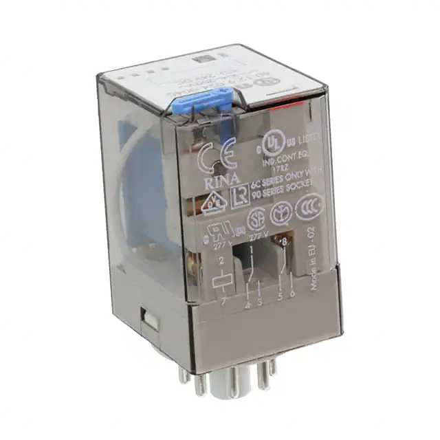

60 Series - General purpose relays 6 - 10 A Features
Plug-in mount 10 A General purpose relay & 3 pole changeover contacts Cadmium Free contacts (preferred version) · AC coils & DC coils · UL Listed (certain relay/socket combinations) · Contact material options · Lockable test button with mechanical flag indicator (preferred version) · 90 series sockets, coil EMC suppression and timer accessories
· ·2
60.12
60.13
  • Тип реле: General Purpose
  • Coil Voltage VDC Nom: 24 В
  • Contact Current Max: 20 А
  • Contact Voltage AC Nom: 250 В
  • Coil Resistance: 445 Ом
  • Contact Configuration: DPCO
  • Coil Type: DC Coil
  • Coil Current: 53.9 мА
  • Nom Operating Power: 1.3 Вт
  • Relay Mounting: Plug-In
  • Внешняя длина / высота: 51 мм
  • Внешняя ширина: 32.5 мм
  • External Depth: 36.2 мм
  • Contact Current AC Max: 10 А
  • Contact Current DC Max: 10 А
  • Contact Voltage AC Max: 250 В
  • Contact Voltage DC Max: 30 В
  • Mounting Type: Plug-In
  • No.
    of Poles: 2
  • Operating Temperature Max: 70°C
  • Series: 60
  • Temperature Operating Min: -40°C
  • Approval Bodies: BSI, VDE, CSA, RINA, UL, BEAB, IMQ, SETI, SEMKO, DEMKO
  • Coil Operating Lower Percent Limit: 80%
  • Coil Operating Upper Percent Limit: 110%
  • Contact Material: Silver Nickel
  • DC Coil Power: 1.3 Вт
  • Dielectric Strength VDC: 2000 В
  • Operating Time: 9 мс
  • Release Time: 9 мс
  • Switch Current Max: 20 А
  • Switched Current Max: 20 А
  • Switched Voltage Max: 400 В
  • Switching Power Max: 2500VA
  • Switching Voltage AC / DC Min: 400 В AC
