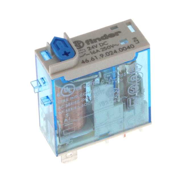

46 Series - Miniature industrial relays, 8 - 16 A Features
1 & 2 Pole relay range 46.52 - 2 Pole 8 A 46.61 - 1 Pole 16 A Socket mount or direct connection via Faston connectors · AC coils & DC coils · Available with: lockable test button, mechanical indicator & LED indicator · 8 mm, 6 kV (1.2/50 µs) isolation, coil-contacts · Cadmium Free contacts
46.52
46.61
  • Тип реле: Miniature
  • Coil Voltage VDC Nom: 24 В
  • Contact Current Max: 25 А
  • Contact Voltage AC Nom: 250 В
  • Coil Resistance: 1.2 кОм
  • Contact Configuration: SPDT
  • Coil Type: DC Coil
  • Coil Current: 20 мА
  • Nom Operating Power: 500 мВт
  • Relay Mounting: Plug-In
  • Внешняя длина / высота: 32.8 мм
  • Внешняя ширина: 29 мм
  • External Depth: 12.4 мм
  • Contact Current AC Max: 25 А
  • Contact Voltage AC Max: 250 В
  • Mounting Type: Plug-In
  • No.
    of Poles: 1
  • Operating Temperature Max: 70°C
  • Series: 46
  • Temperature Operating Min: -40°C
  • Type: Lockable test button + mechanical indicator
  • Approval Bodies: CSA, GOST, RINA, VDE
  • Approval Category: UL Recognised
  • Contact Current Rating: 16 А
  • Contact Material: AgNi
  • Dielectric Voltage Contact to Contact: 1000 В AC
  • No. of Electrical Operations: 100000
  • No. of Mechanical Operations: 10000000
  • Количество выводов: 5
  • Operating Time: 15 мс
  • Release Time: 5 мс
  • Switching Voltage AC / DC Max: 440 В AC
  • Terminal Type: 4.8 мм x 0.5 мм
  • Termination Method: Faston 187 - 4.75 x 6.5 мм
