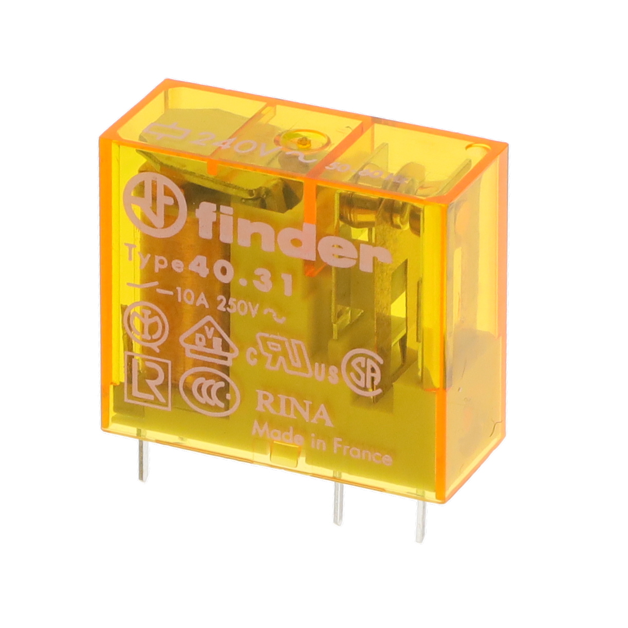

40 Series - Miniature PCB relays 8 - 10 - 16 A Features
1 & 2 Pole relay range 40.31 - 1 Pole 10 A (3.5 mm pin pitch) 40.51 - 1 Pole 10 A (5 mm pin pitch) 40.52 - 2 Pole 8 A (5 mm pin pitch) PCB mount - direct or via PCB socket 35 mm rail mount - via screw and screwless sockets
· DC
40.31
40.51
  • Тип реле: Miniature
  • Coil Voltage VAC Nom: 240 В
  • Contact Current Max: 20 А
  • Contact Voltage AC Nom: 250 В
  • Coil Resistance: 31.5 кОм
  • Contact Configuration: SPCO
  • Coil Type: AC Coil
  • Coil Current: 4.1 мА
  • Nom Operating Power: 1.2VA
  • Relay Mounting: PC Board
  • Внешняя длина / высота: 29 мм
  • Внешняя ширина: 12.4 мм
  • External Depth: 25 мм
  • Contact Current AC Max: 10 А
  • Contact Current DC Max: 10 А
  • Contact Voltage AC Max: 240 В
  • Contact Voltage DC Max: 30 В
  • Mounting Type: PCB
  • No.
    of Poles: 1
  • Operating Temperature Max: 70°C
  • Series: 40
  • Temperature Operating Min: -20°C
  • Approval Bodies: VDE, BEAB, UL, CSA, SEV, NF-USE, SETI, IMQ SEMKO, DEMKO
  • Approval Category: VDE, BEAB, UL, CSA, SEV, NF-USE, SETI, IMQ SEMKO, DEMKO
  • Coil Operating Lower Percent Limit: 80%
  • Coil Operating Upper Percent Limit: 150%
  • Contact Material: Silver Nickel
  • DC Coil Power: 500 мВт
  • Operating Time: 10 мс
  • PCB Hole Diameter: 1.5 мм
  • Release Time: 7 мс
  • Switch Current Max: 10 А
