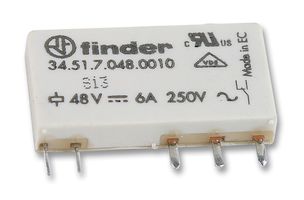

Finder 34.51.7.024.0010
Наименование модели: 34.51.7.024.0010

Описание: Реле, SPCO, 6 А, 24 В DC

34 Series - Slim electromechanical PCB relays 6 A Features
Ultra-slim 1 Pole - 6 A relay Printed circuit mount - direct or via PCB socket 35 mm rail mount - via screw or screwless sockets Pole changeover contacts or 1 Pole normally open contact · Ultra slim, 5 mm, package · Sensitive DC coil - 170 mW (Dual AC/DC coil drive possible using 93 series sockets) · UL Listed (certain relay/socket combinations) · Flux proof: RT II · Cadmium Free contact materials · 8/8 mm clearance/creepage distance · 6 kV (1.2/50 µs) insulation, coil-contacts

  • Тип реле: General Purpose
  • Coil Voltage VDC Nom: 24 В
  • Contact Current Max: 10 А
  • Contact Voltage AC Nom: 250 В
  • Coil Resistance: 3.35 кОм
  • Contact Configuration: SPCO
  • Coil Type: DC Coil, Sensitive
  • Coil Current: 7.1 мА
  • Nom Operating Power: 170 мВт
  • Relay Mounting: PC Board
  • Внешняя длина / высота: 15 мм
  • Внешняя ширина: 28 мм
  • External Depth: 5 мм
  • Contact Current AC Max: 6 А
  • Contact Voltage AC Max: 400 В
  • Mounting Type: PCB
  • No.
    of Poles: 1
  • Operating Temperature Max: 85°C
  • Series: 34
  • Temperature Operating Min: -40°C
  • Approval Bodies: CSA, GOST, UL, VDE
  • Contact Current Rating: 6 А
  • Contact Material: AgNi
  • DC Coil Power: 0.17 Вт
  • No. of Mechanical Operations: 10000000
  • Power Rating: 1500VA
  • Switch Current Max: 10 А
  • Switching Voltage AC / DC Min: 250 В AC
