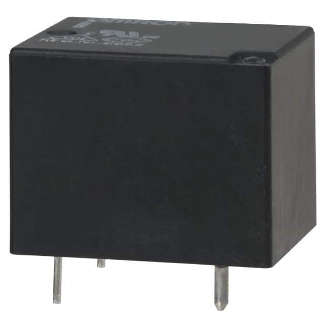

PCB Relay
A Cubic, Single-pole 10A Power Relay Small size and light weight · 19.6 Ч 15.6 Ч 15.6 mm, 7.5g High Insulation · Dielectric strength 2,000V · Withstand impulse voltage 4,500V High heat resistance and tracking performance · UL class-F available (-CF model) · IEC60335 GWT compliant · Tracking resistance CTI>250 Environmental friendly (RoHS compliant)
G5LA
Ordering Information
  • Тип реле: Power
  • Coil Voltage VDC Nom: 12 В
  • Contact Current Max: 10 А
  • Contact Voltage AC Nom: 250 В
  • Contact Voltage DC Nom: 24 В
  • Coil Resistance: 400 Ом
  • Contact Configuration: SPDT
  • Coil Type: DC Coil
  • Coil Current: 30 мА
  • Nom Operating Power: 360 мВт
  • Relay Mounting: PC Board
  • Внешняя длина / высота: 15.6 мм
  • Внешняя ширина: 19.6 мм
  • External Depth: 15.6 мм
  • Contact Current AC Max: 10 А
  • Contact Current DC Max: 10 А
  • Contact Voltage AC Max: 250 В
  • Contact Voltage DC Max: 24 В
  • Mounting Type: PCB
  • No.
    of Poles: 1
  • Operating Temperature Max: 85°C
  • Series: G5LA
  • Temperature Operating Min: -40°C
  • Type: Flux protection
  • Approval Bodies: VDE, CQC
  • Approval Category: UL Recognised
  • Coil Operating Lower Percent Limit: 10%
  • Coil Operating Upper Percent Limit: 75%
  • Contact Material: AgSnO
  • Contact Resistance: 100 MOhm
  • DC Coil Power: 360 мВт
  • Dielectric Voltage Coil to Contact: 2000 В AC
  • Dielectric Voltage Contact to Contact: 750 В AC
  • No. of Mechanical Operations: 100000
  • Operating Time: 10 мс
  • Release Time: 5 мс
RoHS: есть
