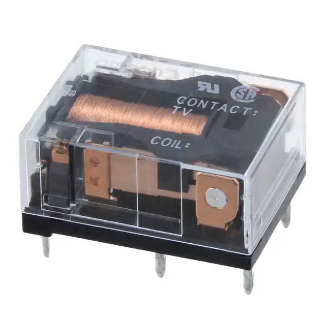

Omron G6CK-1117P-US 5DC
Наименование модели: G6CK-1117P-US 5DC

Производитель: Omron
Описание: Реле, PCB, SPNO, 5 В DC
data sheetСкачать Data Sheet
Краткое содержание документа:
PCB Relay
SPST-NO Type Breaks 10-A Loads; SPST-NO + SPST-NC Type Breaks 8-A Load
G6C
Compact: 20 Ч 15 Ч 10 mm (L Ч W Ч H).
Low power consumption: 200 mW. Flux protection or fully sealed construction available. Unique moving loop armature reduces relay size, magnetic interference, and contact bounce. Single- and double-winding latching types also available RoHS Compliant
Refer to pages 16 to 17 for details.
  • Тип реле: Power
  • Coil Voltage VDC Nom: 5 В
  • Contact Current Max: 10 А
  • Contact Voltage AC Nom: 250 В
  • Contact Voltage DC Nom: 30 В
  • Coil Resistance: 89.3 Ом
  • Contact Configuration: SPST
  • Coil Type: DC Coil
  • Coil Current: 56 мА
  • Nom Operating Power: 280 мВт
  • Relay Mounting: PC Board
  • Внешняя длина / высота: 10 мм
  • Внешняя ширина: 20 мм
  • External Depth: 15 мм
  • Contact Current AC Max: 10 А
  • Contact Current DC Max: 10 А
  • Contact Voltage AC Max: 250 В
  • Contact Voltage DC Max: 30 В
  • Mounting Type: PCB
  • No. of Poles: 1
  • Series: G6C
  • Temperature Operating Min: 70°C
  • Type: Double Winding - Latching
  • Approval Bodies: CSA, VDE, SEV and TUV
  • Approval Category: UL Recognised
  • Coil Operating Lower Percent Limit: 70%
  • Coil Operating Upper Percent Limit: 70%
  • Contact Material: Ag Alloy
  • Contact Resistance: 30 MOhm
  • Current Rating: 10 А
  • DC Coil Power: 280 мВт
  • Dielectric Strength VAC: 2000 В AC
  • Dielectric Voltage Coil to Contact: 2000 В AC
  • Dielectric Voltage Contact to Contact: 1000 В AC
  • Insulation Resistance: 1000 MOhm
RoHS: есть
