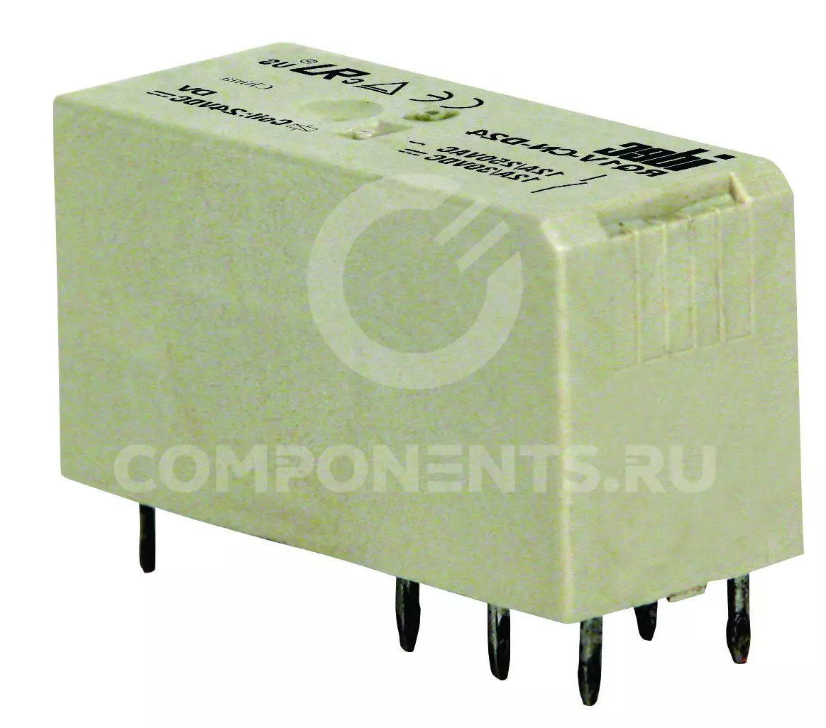

RQ Series RQ Series -- General Purpose Relays
IDEC's RQ relays are low-profile, PCB relays that provide quality within a compact package.
Size equals value. RQ relays are small, yet maintain high contact ratings and long operational life. For larger power needs, a 16A model is also available. Key features of the RQ series include: · Low profile: 29 x 12.7 x 15 mm · Contact rating: 8A (DPDT) and 12A (SPDT) · Power relay model with 16A contact rating (SPDT) · Operational life: 100K cycles at full resistive load 10 million cycles, no load · LED/Diode Plug-in modules available with DIN rail socket · Lead-free
Relays
E
Relays
  • Тип реле: General Purpose
  • Coil Voltage VDC Nom: 24 В
  • Contact Current Max: 8 А
  • Coil Resistance: 1440 Ом
  • Contacts: DPDT
  • Coil Type: DC, Sensitive
  • Coil Current: 16.7 мА
  • Nom Operating Power: 400 мВт
RoHS: есть
