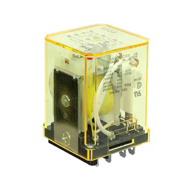

RR Series RR Series -- General Purpose Power Relays
Key features of the RR series include: · High reliability and long service life · Available in octal (8- and 11-pin) or square (11-blade) base · Options include check button for test operation, indicator light, and side flange (contact IDEC for diodes) · DIN rail, surface and panel type sockets available for a wide range of mounting applications
Relays
Contact Material Contact Resistance Minimum Applicable Load Operating Time
Silver 30m maximum (initial value) 24V DC/10mA, 5V DC/20mA (reference value) 25ms maximum 25ms maximum 110% of the rated voltage UL Recognized File No.
E66043 CSA Certified File No. LR35144
  • Тип реле: General Purpose
  • Coil Voltage VDC Nom: 110 В
  • Contact Current Max: 10 А
  • Contact Voltage AC Nom: 220 В
  • Contact Voltage DC Nom: 30 В
  • Coil Resistance: 8460 Ом
  • Contacts: 3PDT
  • Coil Type: DC
RoHS: есть
