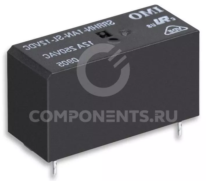

Описание: Мощное реле SPDT-CO 24 В постоянный ток, 12 А, PC BOARD
data sheetСкачать Data Sheet
Краткое содержание документа:
Miniature High Power Relay SRRHN/SRP
Low height 15.7mm 16A switching capabilities 1 & 2 pole configuration 5KV dielectric coil to contacts Creepage distance 10mm Sealed & Flux-Tight construction
Options and ordering codes
SRRHN/SRP SRRHN 12A Single Pole 8A Double Pole SRP 16A Single Pole Contact Form SPNO SPNC SPCO DPNO DPNC DPCO SPNO 5mm Pin Spacing SPNC 5mm Pin Spacing SPCO 5mm Pin Spacing
1C
  • Coil Resistance: 14.4 кОм
  • Coil Voltage VDC Nom: 24 В
  • Contact Current Max: 12 А
  • Contact Voltage AC Nom: 440 В
  • Contact Voltage DC Nom: 125 В
  • Конфигурация контактов: SPST-CO
  • Тип реле: Miniature
  • RoHS: да
SRRHN1CNSL24VDC, SRRHN 1CN SL 24VDC
