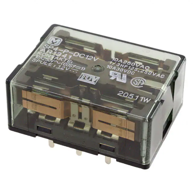

SP
2c 15A, 4c 10A polarized power relays
SP RELAYS
FEATURES
1.
Small, slim form factor Facilitating the form factor reduction of devices, the overall height of the relay package is less than half that of our HP relay. 2. High sensitivity The high-efficiency polarized electromagnetic mechanism in conjunction with our exclusive spring alignment method achieves levels of sensitivity higher than relays that have been available up to now. For both the 2 Form C and 4 Form C single side stable and 2 coil latching types, the 150 mW minimum operating power level allows direct driving by transistor or chip controllers. 3. High reliability and long life With a structure that ensures almost perfectly complete twin contact and minimal contact bounce, you get greater reliability than has so far been provided by power relays. 4. Latching types also available 1 coil latching and 2 coil latching types are available. In cases where it was formerly unavoidable to use plural relays for large power memory
  • Тип реле: Polarized
  • Coil Voltage VDC Nom: 12 В
  • Contact Current Max: 10 А
  • Contact Voltage AC Nom: 250 В
  • Contact Voltage DC Nom: 30 В
  • Coil Resistance: 480 Ом
  • Конфигурация контактов: 4PDT
  • Coil Type: DC
RoHS: есть
SP4PDC12V, SP4 P DC12V
На английском языке: Datasheet SP4-P-DC12V - Panasonic POWER RELAY, 12 V DC, 10 A, 4PDT, PCB
