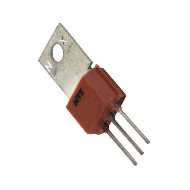

NTE268 (NPN) & NTE269 (PNP) Silicon Complementary Transistors Darlington Power Amplifier
Description: The NTE268 (NPN) and NTE269 (PNP) are silicon complementary Darlington transistors in a TO202 type package designed for amplifier and driver applications where high gain is an essential require ment, low power lamp and relay drivers and power drivers for high-current applications such as volt age regulators.
Features: D Low Collector-Emitter Saturation Voltage: VCE(sat) = 1.5V Max @ IC = 1.5A D TO202 Type Package: 2W Free Air Dissipation @ TA = +25°C Absolute Maximum Ratings: Collector-Emitter Voltage, VCEO . . . . . . . . . . . . . . . . . . . . . . . . . . . . . . . . . . . . . . . . . . . . . . . . . . . . . . 50V Collector-Emitter Voltage, VCES . . . . . . . . . . . . . . . . . . . . . . . . . . . . . . . . . . . . . . . . . . . . . . . . . . . . . . 50V Emitter-Base Voltage, VEBO . . . . . . . . . . . . . . . . . . . . . . . . . . . . . . . . . . . . . . . . . . . . . . . . . . .
  • Полярность транзистора: PNP
  • Collector Emitter Voltage V(br)ceo: -50 В
  • Power Dissipation Pd: 40 Вт
  • DC Collector Current: 4 А
  • DC Current Gain Max (hfe): 2000
  • Рабочий диапазон температрур: -55°C ... +150°C
