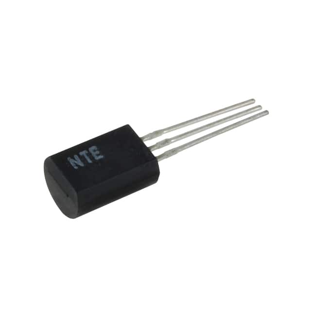

NTE31 (NPN) & NTE32 (PNP) Silicon Complementary Transistors TV Sound Output, TV Vertical Output, AF Driver Output
Features: D High Voltage: VCEO = 160V D High Continuous Collector Current Capability Applications: D Vertical Deflection Output & Sound Output Applications for Line Operated TV Absolute Maximum Ratings: (TA = +25°C unless otherwise specified) Collector­Base Voltage, VCBO .
. . . . . . . . . . . . . . . . . . . . . . . . . . . . . . . . . . . . . . . . . . . . . . . . . . . . . 160V Collector­Emitter Voltage, VCEO . . . . . . . . . . . . . . . . . . . . . . . . . . . . . . . . . . . . . . . . . . . . . . . . . . . . . 160V Emitter­Base Voltage, VEBO . . . . . . . . . . . . . . . . . . . . . . . . . . . . . . . . . . . . . . . . . . . . . . . . . . . . . . . . . . 6V Collector Current, IC . . . . . . . . . . . . . . . . . . . . . . . . . . . . . . . . . . . . . . . . . . . . . . . . . . . . . . . . . . . . . . . . . 1A Base Current, IB . . . . . . . . . . . . . . . . . . . .
  • Полярность транзистора: NPN
  • Collector Emitter Voltage V(br)ceo: 160 В
  • Transition Frequency Typ ft: 100 МГц
  • Power Dissipation Pd: 900 мВт
  • DC Collector Current: 1 А
  • DC Current Gain Max (hfe): 200
RoHS: есть
На английском языке: Datasheet NTE31 - NTE Electronics BIPOLAR TRANSISTOR, NPN, 160 V
