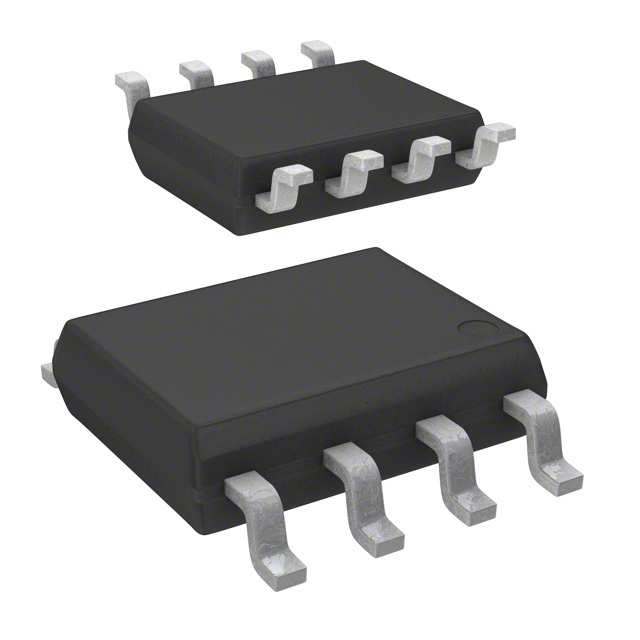

FDR8308P Dual P-Channel, Logic Level, PowerTrenchTM MOSFET
General Description
The SuperSOT-8 family of P-Channel Logic Level MOSFETs have been designed to provide a low profile, small footprint alternative to industry standard SO-8 little foot type product.
These P-Channel Logic Level MOSFETs are produced using Fairchild Semiconductor's advanced PowerTrench process that has been tailored to minimize the on-state resistance and yet maintain superior switching performance. These devices are well suited for portable electronics applications: load switching and power management, battery charging circuits, and DC/DC conversion.
Features
  • Полярность транзистора: Dual P
  • Current Id Max: 3.2 А
  • Drain Source Voltage Vds: 20 В
  • On Resistance Rds(on): 0.05 Ом
  • Rds(on) Test Voltage Vgs: -4.5 В
  • Power Dissipation: 0.8 Вт
  • Корпус транзистора: Super-SOT
  • Количество выводов: 8
  • Количество транзисторов: 2
  • Тип корпуса: SuperSOT-8
  • Способ монтажа: SMD
  • Тип транзистора: MOSFET
  • Continuous Drain Current Id: 3.2 А
  • Current Temperature: 25°C
  • Full Power Rating Temperature: 25°C
  • Power Dissipation Pd: 0.8 Вт
  • Pulse Current Idm: 20 А
  • SMD Marking: FDR8308P
  • Voltage Vds: 20 В
  • Voltage Vgs th Max: -1.5 В
