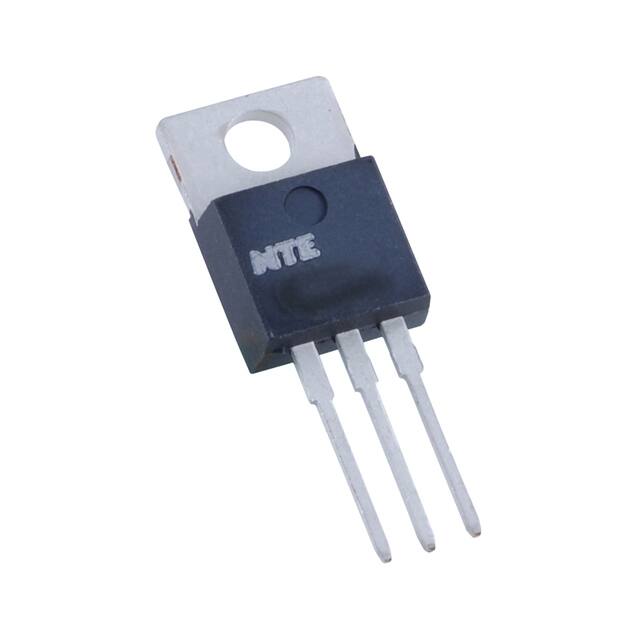

NTE6086 Silicon Dual Schottky Rectifier 100V, 10 Amp, TO220
Description: The NTE6086 is a silicon dual power rectifier in a TO220 type package designed using the Schottky Barrier principle with a platinum barrier metal.
Features: D 20 Amps Total (10 Amps Pre Diode Leg) D Guarding for Stress Protection D Low Forward Voltage D +150°C Operating Junction Temperature D Guaranteed Reverse Avalanche Absolute Maximum Ratings (Per Diode Leg): Peak Repetitive Reverse Voltage, VRRM . . . . . . . . . . . . . . . . . . . . . . . . . . . . . . . . . . . . . . . . . . . . . . 100V Working Peak Reverse Voltage, VRWM . . . . . . . . . . . . . . . . . . . . . . . . . . . . . . . . . . . . . . . . . . . . . . . 100V DC Blocking Voltage, VR . . . . . . . . . . . . . . . . . . . . . . . . . . . . . . . . . . . . . . . . . . . . . . . . . . . . . . . . . . . 100V Average Rectified Forward Current (VR = 100V, TC = +133°C), IF(AV) . . . . . . . . . . . . . . . . . . . . . . 10A Peak Repetitive Forward Current
  • Diode Configuration: Dual Common Cathode
  • Diode Type: Schottky
  • Repetitive Reverse Voltage Vrrm Max: 100 В
  • Forward Current If(AV): 10 А
  • Forward Voltage VF Max: 700 мВ
RoHS: есть
