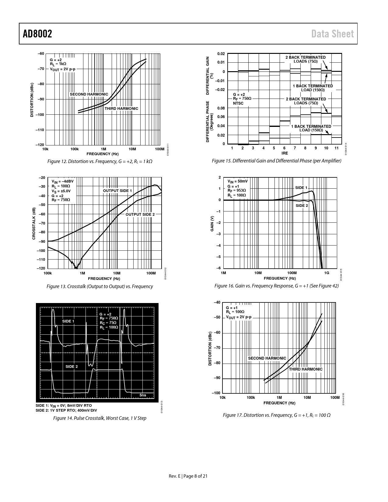

AD8002. Data Sheet. –60. 0.02. 2 BACK TERMINATED. G = +2. LOADS (75Ω). 0.01. L = 1kΩ. –70. L GA. OUT = 2V p-p. TIA N. (%). –0.01. –80. Bc)
AD8002 Data Sheet –60 0.02 2 BACK TERMINATED G = +2 LOADS (75Ω) 0.01 L = 1kΩ –70 L GA OUT = 2V p-p TIA N (%) –0.01 –80 Bc)

AD8002 Data Sheet –60 0.02 2 BACK TERMINATED G = +2 IN LOADS (75Ω) R 0.01 L = 1kΩ –70 V L GA OUT = 2V p-p 0 TIA N (%) E –0.01 –80 R Bc) 1 BACK TERMINATED (d –0.02 IFFE LOAD (150Ω) SECOND HARMONIC D G = +2 –90 RF = 750Ω 2 BACK TERMINATED TION E NTSC LOADS (75Ω) TOR THIRD HARMONIC 0.08 HAS IS P D –100 0.06 IAL rees) NT 0.04 1 BACK TERMINATED –110 RE (Deg LOAD (150Ω) E F 0.02 F DI –120 0
011 014
10k 100k 1M 10M 100M 1 2 3 4 5 6 7 8 9 10 11 FREQUENCY (Hz) IRE
01044- 01044- Figure 12. Distortion vs. Frequency, G = +2, RL = 1 kΩ Figure 15. Differential Gain and Differential Phase (per Amplifier)
–20 2 VIN = –4dBV VIN = 50mV –30 RL = 100Ω G = +1 1 SIDE 1 V OUTPUT SIDE 1 R S = ±5.0V F = 953Ω –40 G = +2 RL = 100Ω RF = 750Ω 0 –50 SIDE 2 B) d –1 –60 OUTPUT SIDE 2 K ( ) V AL –70 –2 T N ( S AI S –80 G –3 CRO –90 –4 –100 –5 –110 –120 –6
012
100k 1M 10M 100M 1M 10M 100M 1G
015
FREQUENCY (Hz)
01044-
FREQUENCY (Hz)
01044- Figure 13. Crosstalk (Output to Output) vs. Frequency Figure 16. Gain vs. Frequency Response, G = +1 (See Figure 42)
–40 G = +1 R G = +2 L = 100Ω R –50 V F = 750Ω OUT = 2V p-p SIDE 1 RC = 75Ω RL = 100Ω ) –60 c dB ( –70 TION TOR SECOND HARMONIC IS –80 D SIDE 2 THIRD HARMONIC –90 –100 5ns 10k 100k 1M 10M 100M
016 013
FREQUENCY (Hz) SIDE 1: V
01044-
IN = 0V; 8mV/DIV RTO SIDE 2: 1V STEP RTO; 400mV/DIV
01044- Figure 17. Distortion vs. Frequency, G = +1, R Figure 14. Pulse Crosstalk, Worst Case, 1 V Step L = 100 Ω Rev. E | Page 8 of 21 Document Outline Features Applications General Description Pin Connection Block Diagram Table of Contents Revision History Specifications Absolute Maximum Ratings Maximum Power Dissipation ESD Caution Pin Configurations and Function Descriptions Typical Performance Characteristics Test Circuits Theory of Operation Choice of Feedback and Gain Resistors Printed Circuit Board (PCB) Layout Considerations Power Supply Bypassing DC Errors and Noise Driving Capacitive Loads Communications Operation as a Video Line Driver Driving ADCs Single-Ended-to-Differential Driver Using an AD8002 Applications Information Layout Considerations Outline Dimensions Ordering Guide
