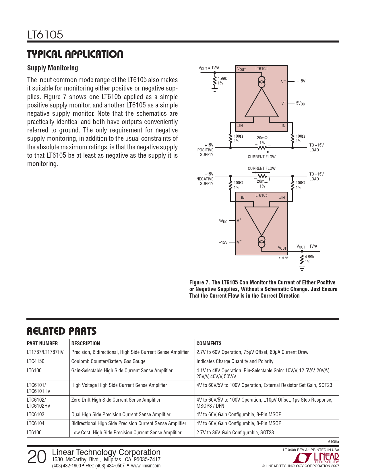

TYPICAL APPLICATION
V
Supply Monitoring
OUT = 1V/A V LT6105 OUT 4.99k The input common mode range of the LT6105 also makes V – –15V 1% it suitable for monitoring either positive or negative sup- plies. Figure 7 shows one LT6105 applied as a simple V+ 5VDC positive supply monitor, and another LT6105 as a simple negative supply monitor. Note that the schematics are practically identical and both have outputs conveniently +IN –IN referred to ground. The only requirement for negative 100Ω 100Ω 20mΩ supply monitoring, in addition to the usual constraints of 1% 1% 1% +15V + – TO +15V the absolute maximum ratings, is that the negative supply POSITIVE LOAD SUPPLY to that LT6105 be at least as negative as the supply it is CURRENT FLOW monitoring. CURRENT FLOW –15V TO –15V – + NEGATIVE LOAD 20mΩ SUPPLY 100Ω 100Ω 1% 1% 1% LT6105 –IN +IN 5V V+ DC –15V V– VOUT = 1V/A VOUT 6105 F07 4.99k 1%
Figure 7. The LT6105 Can Monitor the Current of Either Positive or Negative Supplies, Without a Schematic Change. Just Ensure That the Current Flow Is in the Correct Direction RELATED PARTS PART NUMBER DESCRIPTION COMMENTS
