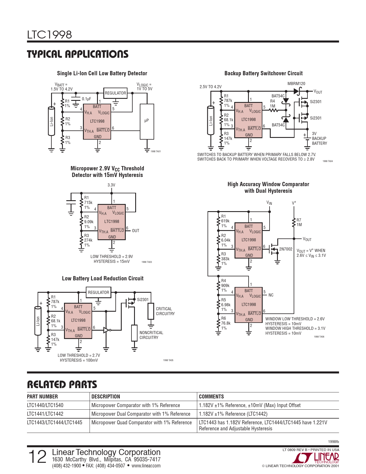

TYPICAL APPLICATIONS. Single Li-Ion Cell Low Battery Detector. Backup Battery Switchover Circuit
TYPICAL APPLICATIONS Single Li-Ion Cell Low Battery Detector Backup Battery Switchover Circuit
V V MBRM120 BATT = LOGIC = 2.5V TO 4.2V 1.5V TO 4.2V 1V TO 5V VOUT REGULATOR R1 BAT54C 0.1μF 1 R1 1 787k R4 + Si2301 + 1% 1% BATT 4 BATT 5 1M 4 5 V V H.A VLOGIC VH.A LOGIC R2 R2 μP 68.1k Si2301 LTC1998 LTC1998 1% Li-Ion Li-Ion 1% 3 6 BAT54C 3 6 V BATTLO BATTLO TH.A VTH.A R3 GND + 3V R3 GND 147k BACKUP 2 1% 2 1% BATTERY 1998 TA01 SWITCHES TO BACKUP BATTERY WHEN PRIMARY FALLS BELOW 2.7V. SWITCHES BACK TO PRIMARY WHEN VOLTAGE RECOVERS TO ≥ 2.8V 1998 TA04
Micropower 2.9V VCC Threshold Detector with 15mV Hysteresis
3.3V
High Accuracy Window Comparator with Dual Hysteresis
R1 1 715k VIN V+ 1% 4 BATT 5 VH.A VLOGIC R2 R1 1 9.09k LTC1998 619k R7 1% 1% 1M 3 6 4 BATT 5 V BATTLO OUT TH.A VH.A VLOGIC R3 R2 GND 274k 6.04k LTC1998 VOUT 2 1% 1% 3 6 V BATTLO TH.A 2N7002 VOUT = V+ WHEN R3 GND 2.6V ≤ V LOW THRESHOLD = 2.9V IN ≤ 3.1V 383k HYSTERESIS = 15mV 1998 TA03 2 1%
Low Battery Load Reduction Circuit
R4 1 909k 1% REGULATOR 4 BATT 5 R1 VH.A VLOGIC NC 1 Si2301 787k R5 + LTC1998 1% 6.98k BATT 4 5 CRITICAL V 1% H.A VLOGIC 3 6 CIRCUITRY V BATTLO R2 TH.A R6 WINDOW LOW THRESHOLD = 2.6V 68.1k LTC1998 GND Li-Ion 76.8k HYSTERESIS = 10mV 1% 3 6 2 V BATTLO 1% WINDOW HIGH THRESHOLD = 3.1V TH.A R3 NONCRITICAL HYSTERESIS = 10mV GND 1998 TA06 147k CIRCUITRY 2 1% LOW THRESHOLD = 2.7V 1998 TA05 HYSTERESIS = 100mV
