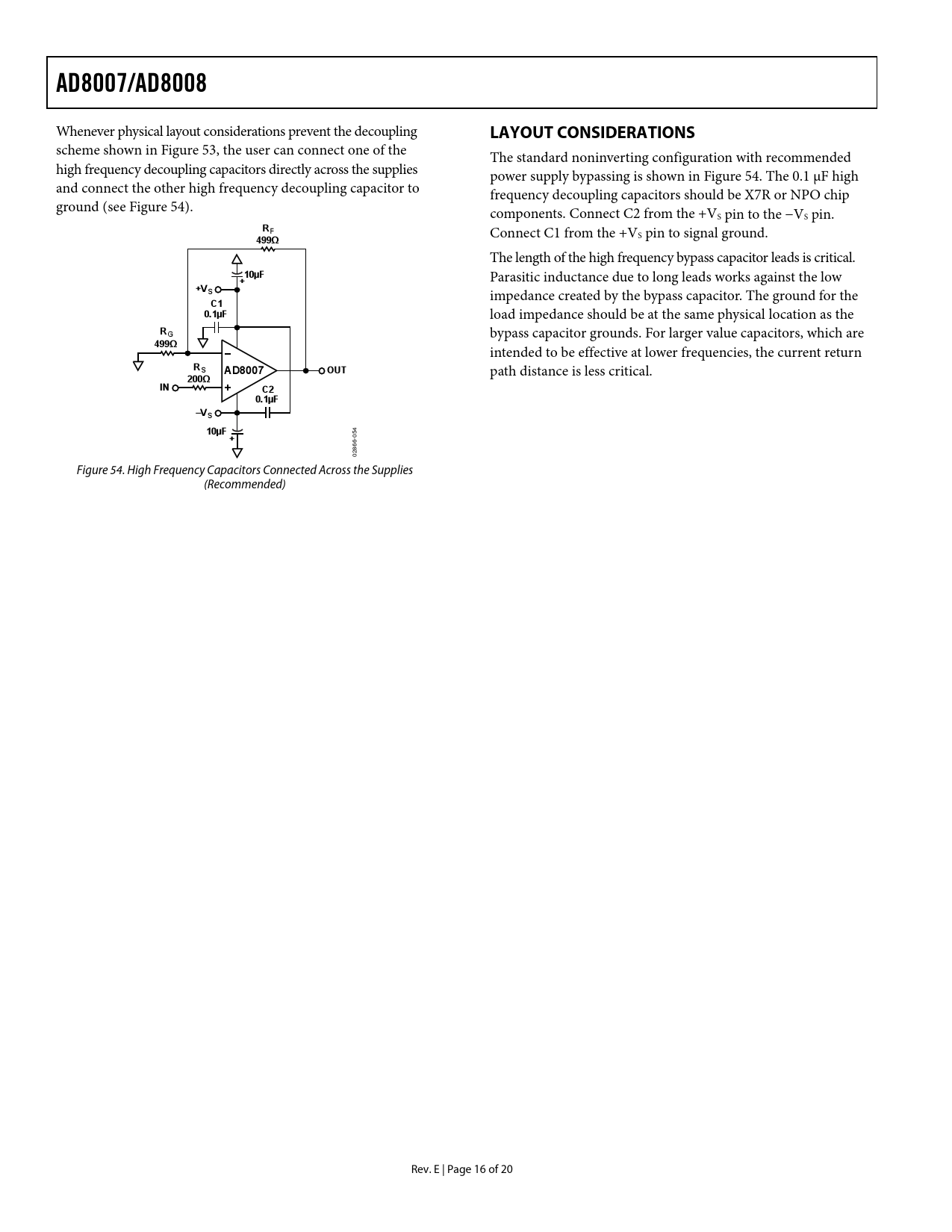

Whenever physical layout considerations prevent the decoupling
LAYOUT CONSIDERATIONS
scheme shown in Figure 53, the user can connect one of the The standard noninverting configuration with recommended high frequency decoupling capacitors directly across the supplies power supply bypassing is shown in Figure 54. The 0.1 μF high and connect the other high frequency decoupling capacitor to frequency decoupling capacitors should be X7R or NPO chip ground (see Figure 54). components. Connect C2 from the +VS pin to the −VS pin.
RF
Connect C1 from the +V
499Ω
S pin to signal ground. The length of the high frequency bypass capacitor leads is critical.
10µF +
Parasitic inductance due to long leads works against the low
+VS
impedance created by the bypass capacitor. The ground for the
C1 0.1µF
load impedance should be at the same physical location as the
RG
bypass capacitor grounds. For larger value capacitors, which are
499Ω
intended to be effective at lower frequencies, the current return
RS AD8007 OUT
path distance is less critical.
200Ω IN C2 0.1µF –VS 10µF
